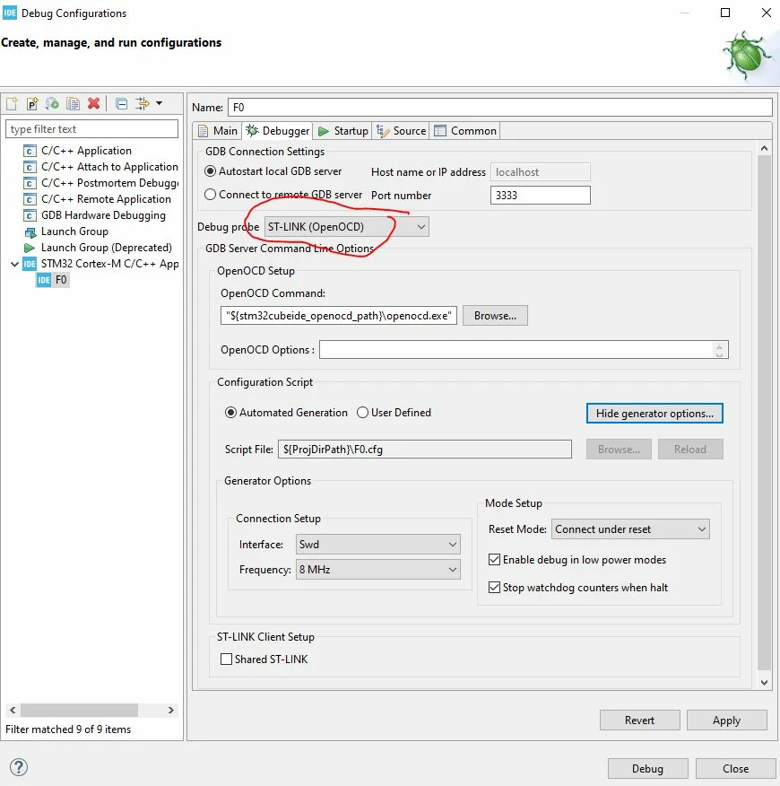

Cartu38 OpenDev
Graduate II
August 4, 2020
Have a try based on OpenOCD usage too ... CubeProgrammer usage is skipped here.
