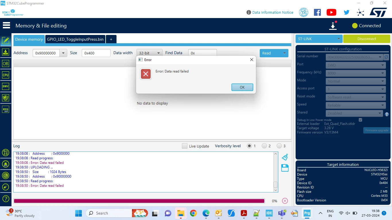

I am using NUCLEO-H563ZI evaluation board and i want to create external flash loader for IS25LP128 QSPI flash memory. I used external loader files from GIT HUB and .stldr file in STCUBE programmer external loader folder location. when i try to read from 0x90000000 location, i am getting read failure error. I used the below path to create external loader for IS25LP128 QSPI flash memory,
stm32-external-loader/Loader_Files/other devices at contrib · STMicroelectronics/stm32-external-loader · GitHub
Could you please help me to solve the below issue?

    >>What could be the reason for Init function not called?
    I don't know, use your imagination.
    Set the STM32 Cube Programmer side to Verbose Logging Level 3, see what it's doing.
    Make sure it pulls in the loader image to RAM, that it correctly identifies the Init() entry point, and calls it. Use objdump or fromelf to dump/disassemble the .STLDR
    Other H5 loaders use 0x20003004 as the basis, not 0x20000004 or 0x24000004

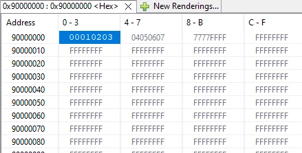

    While debugging i found out that if it is charcter string, i am able to wirte n number of bytes but if it is numerical value, i am able to store only 8 bytes.
    for example, i am trying to store 1 to 24 values in flash but it is storing 1 to 8 only after that it is writing/reading some junk values. Could you please help me to solve this issue.
    for(int i=0; i<24; i++)
    data_Fl[i] = i;
    Enter_QPI_Mode();
    HAL_Delay(50);
    QSPI_data_erase_handler_4Lines(ERASE_BLOCK, (uint32_t)BLOCK0_64K_ADDR);
    HAL_Delay(500);
    QSPI_data_write_handler_4Lines((uint32_t)BLOCK0_64K_ADDR, &data_Fl[0], sizeof(data_Fl));
    HAL_Delay(500);

    Likely an issue with the write code not shown. Either the transfer or waiting for the completion. Don't view the peripheral registers in the debugger, it will break the FIFO

    After putting external pull up and pull down resistor in HOLD and WP pins accordingly, i am able to pass main test but still i am facing data read failure with external loader file. I feel like there is a problem with Loader_src.c file. Anybody having STM32H5 series working loader files?
    NagarajanAuthor
    Apr 25, 2024 1:32 PM UTC
    There are two changes needed in Loader files. One is RAM address need to be changed to 0x20003004 in linker.ld and Loader_Src.c files. Another one is We need to deinit and init QuadSPI everytime when we do erase and write In Loader_Src.c file. With those changes external loader works fine for STM32H563 controller.
