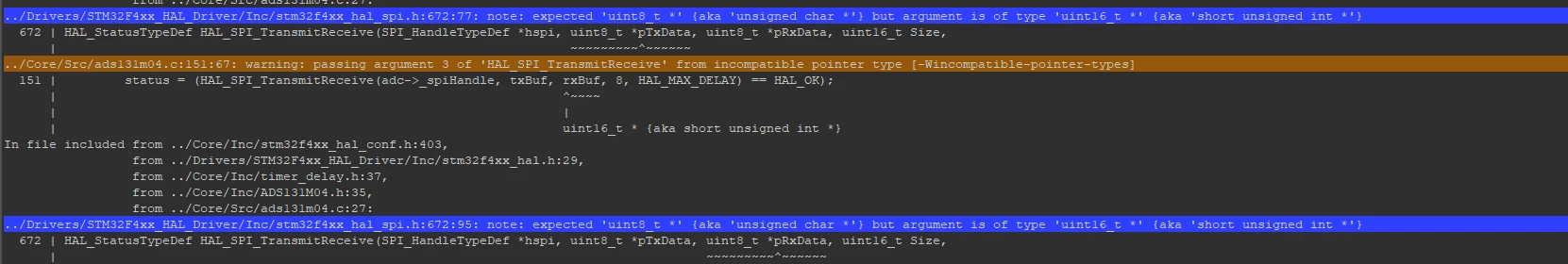

I am getting a warning during compile of an incompatible pointer type when I call the SPI TransmitReceive function as shown below.Compiler warningCompiler warning

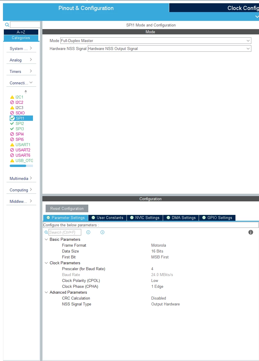

I am passing the function an unsigned 16 bit integer array.  I have configured the SPI to use 16 data bits, as shown below in CubeMX.

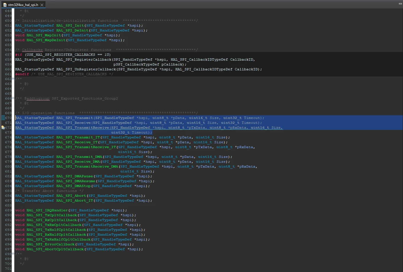

While digging into the HAL functions, I noticed that all the Transmit and Receive functions were expecting a pointer to an unsigned 8 bit value, shown below.  If the SPI peripheral is suppose to be able to accept either 8 or 16 data bits, wouldn't the expected type be the maximum size it can accept or two different sets of functions for either 8 data bits or 16 data bits?

@Enforcer83 wrote:
While digging into the HAL functions, ...
You need to dig a little deeper.
You'll see that, inside the function, it checks whether the SPI is configured for 8 or 16 bits, and behaves accordingly
No - then it wouldn't work for 8-bit data (it would skip every other byte).
16-bit data is just pairs of 8-bit bytes - so uint8_t is used as the "lowest common denominator".
