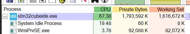

Extreme resource consumption. Very slow.
STMCubeIDE doing nothing:
Starting new project - 2-5 minutes to load uC selector.
Computer Intel-i9 64G ram, fastest available on the market SSDs. It is going worse and worse with every version.

CubeIDE is Eclipse and it is built on Java. It cannot be efficient by design! Read about it and other IDEs there:
https://community.st.com/s/question/0D53W00000U7PcHSAV/keil-vs-stm-ide
By the way, while sitting and doing nothing, EmBitz uses 85 MB and 0% CPU time. Starting takes a few seconds on a 10 years old dual-core with a cheap SATA SSD. Debugging is quick, not like on the lagging Eclipsoids...

This is unusual and should not happen. More details, please?
Can it be related to updates? the indexer went nuts?
Some "security" crapware fighting with java?
