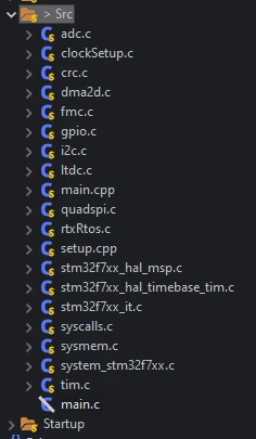

since I have upgraded to 1.7.0 a few of my C++ projects stopped working. When I code in C++ I always create main.cpp file and I exclude from all builds main.c file (I don't delete this file as it is always generated by CubeMX). This has been working for a long time.
But now it crashes. It still try to compile main.c file. What's more, if I delete main.c file, linker tells me that it cannot find main symbol. For some reason compiler doesn't compile my main.cpp file. I have C++ nature set up and all other .cpp files are compiled, but not the main.cpp...

Ok, maybe I didn't wrote it clearly enough.
When I mentioned duplicated symbols I meant i.e. functions like Error_Handler(), assert_failed(). These functions originally exists in the main.c file. I copy them to the, lets say, setup.cpp file. Then I copy the main() function to the main.cpp file.
I exclude from the build file main.c as I don't need it. Remaining two files main.cpp (with main() function) and setup.cpp (with other functions) contains all necessary definitions.
During the compilation I can still see gcc compiling main.c file, g++ compiling setup.cpp file (here are duplicated symbols) and the main.cpp file is ignored.
My active config is always set to debug. The icon is crossed, but not grayed in the Project Explorer. Now the question why...
