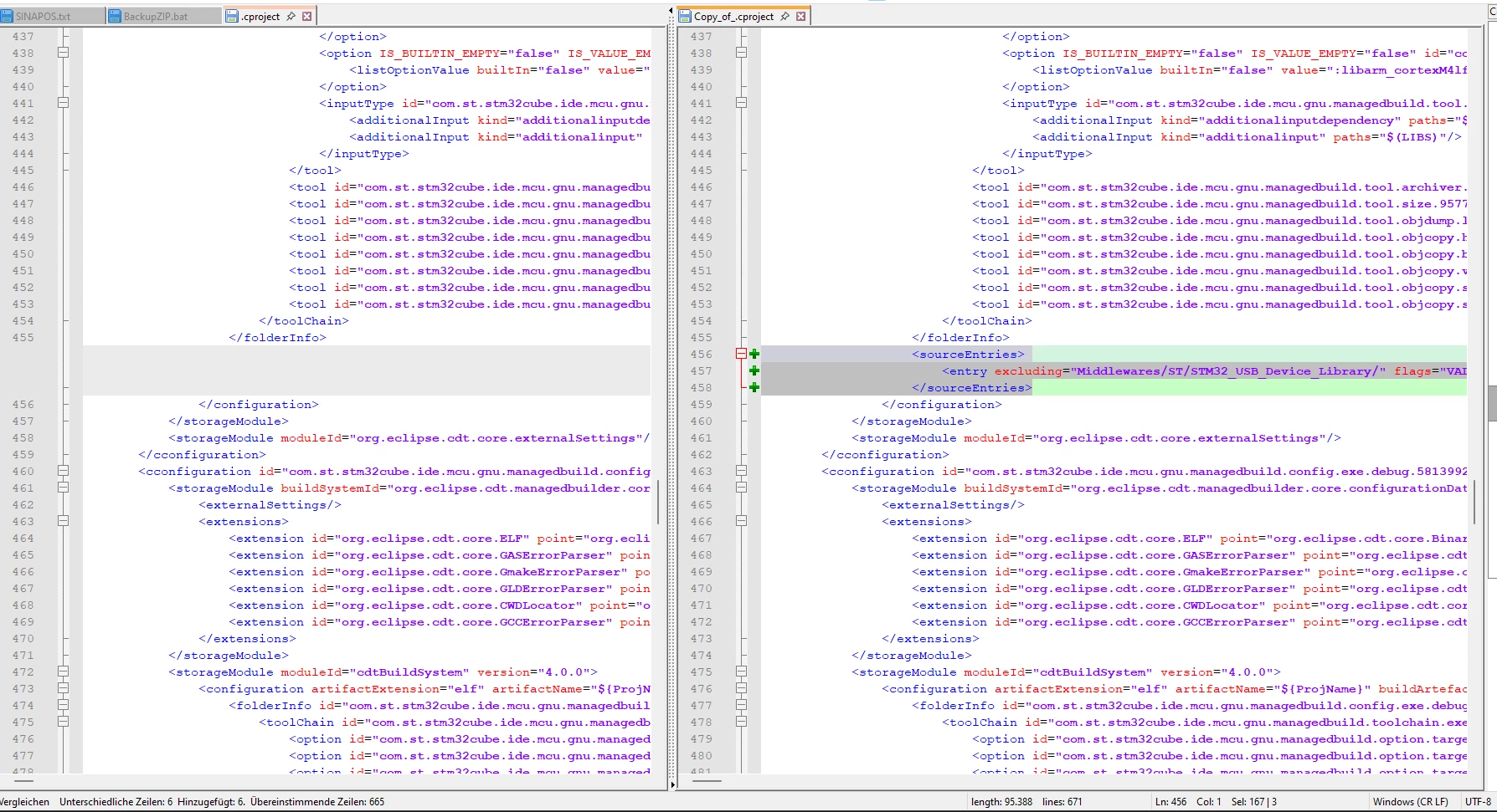

As far as I can tell the custom Build configurations are stored in the .cproject file.
I added two custom build configurations: NO_CDC and CDC2:
And then added a Filter under C/C++ General → Paths and Symbols → Source Location for both Custom configurations.
Those Filters show up in the .cproject file in lines 457 and 614:
<sourceEntries>
<entry excluding="Middlewares/ST/STM32_USB_Device_Library/" flags="VALUE_WORKSPACE_PATH" kind="sourcePath" name=""/>
</sourceEntries>
I attached two .cproject files in ZIP archive:
  1. Copy_of_.cproject: This file I saved after adding custom configurations and Filters in CubeIDE but before “GENERATE CODE” in CubeMX. You can see the Name of the Custom config in line 307 (and 476 resp.) . And you can see the excluded folder in line 457 (and 614 resp.)
  2. The .cproject file after “GENERATE CODE” in CubeMX. The two custom configs are still there but the exclusions in lines 457 and 614 are missing. Everything else is identical. I used Notepad++ with Compare plus plugin to compare the two files. There are only 6 lines different (2x 3 lines for the exclusions).
Can you confirm? And if so, report the bug please.

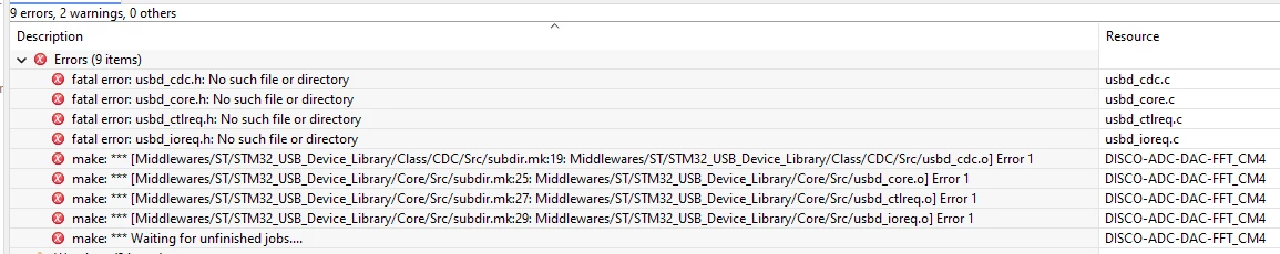

My question originates from the following situation: I use USB CDC on CM7 of a STM32H745 dual core MCU. CubeMX generates the STM32_USB_Device_Library under $projectRoot$/Middlewares/ST i.e. not in the Middlewares folder of CM7 but one level up.
But if I then compile the CM4 I get errors that e.g. usbd_cdc.h could not be found even though there is nothing relating to USB on the CM4, only CM7 (which by the way compiles just fine). I attached the IOC file.
Excluding the STM32_USB_Device_Library folder from compiling on the CM4 fixes the problem, i.e. the build compiles. But if I then “Generate Code” in CubeMX, even without making any changes, the exclusion is gone and the CM4 build fails with the above mentiones errors. Thats what I tried to say with my first post.

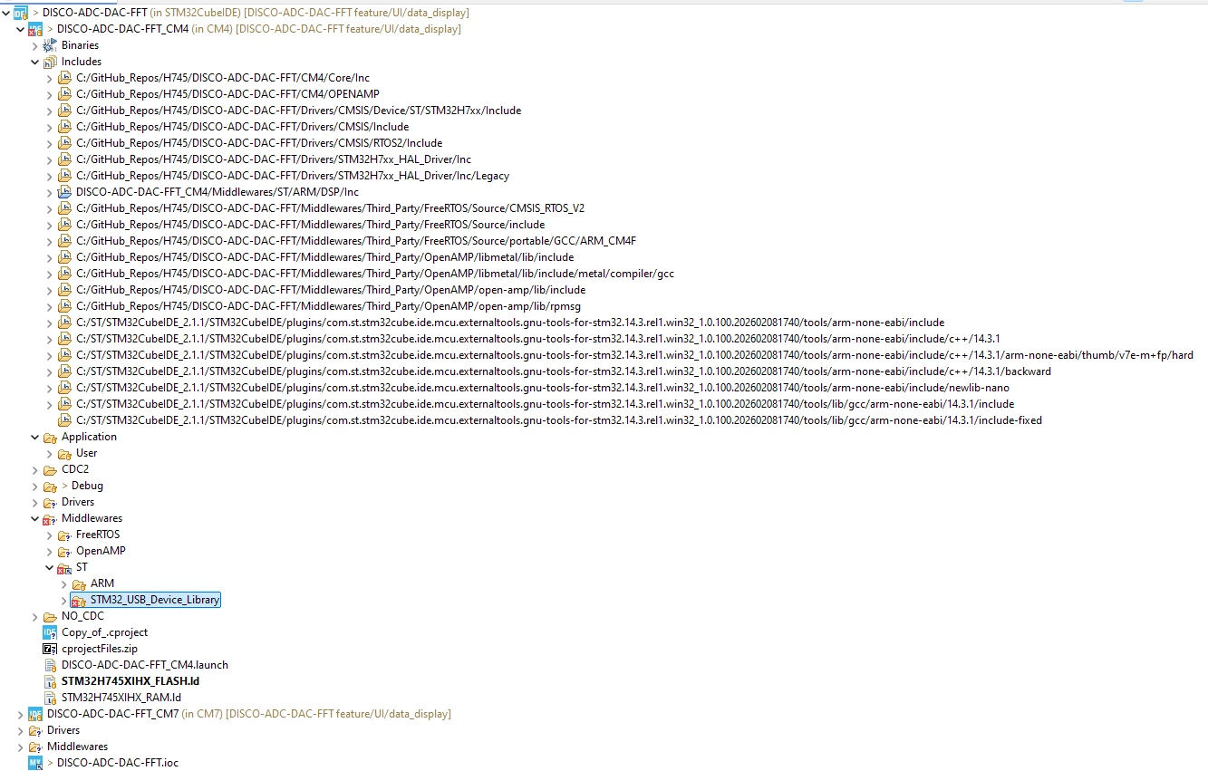

Jun 10, 2026 11:51 AM UTC
Sorry for double post but I could not modify my previous post.
  1. I forgot to mention that the path to that STM32_USB_Device_Library is not specifically included on CM4. I don’t know why CubeIDE includes it in the first place. Maybe thats the real question here.
  2. The custom configs NO_CDC and CDC2 do the same because CDC2 was added for test purposes. I wanted to see if the exclusion is not deleted if the configuration (CDC2) is done by copying from a config that is not the debug config. I.e NO_CDC was derived by copying the current debug config and CDC2 was derived by copying from NO_CDC config. But in .cproject you can see that CDC2’s parent is also “debug” (line 476).
