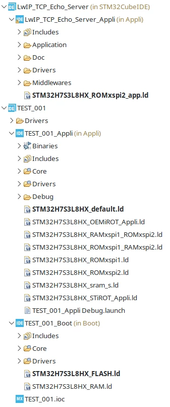

I imported different example projects, but when I want to debug the project, I get this error
"Failed to execute MI command:
load /home/[User]/STM32CubeIDE/workspace_1.17.0/[Example]/STM32CubeIDE/Appli/Debug/[Example]_Appli.elf"
(complete output below)
I tried Linux Kubuntu 24.04 and Windows 10 (VirtualBox), the on board ST-Link v3 (JP1 open) and external ST-Link v3 (JP1 set). Then I created a new Project without any user code and it works.
Next I tried an example project for NUCLEO-F446ZE (on board ST-Link v2-1) and it works fine, too.
In addition, the example Project "LwIP_HTTP_Server_Raw" for H7S3L8 even caanot be imported. After pressing "Finish" the windows remains open with the error message "Fail to perform local copy" on top. With "Cancel", the example is not listed in the prject explorer, but is present on the file system (workspace). After this, the folder from the workspace can be imported an the project can be build without an error. Then I get the same error like described above.
As a consequence, I think it's a bug, maybe only affecting this board.

Best answer by Mahmoud Ben Romdhane
Hello @oxc07w2 ,
This application runs from the external Flash memory (LwIP_TCP_Echo_Server Appli).
It boots from internal Flash (Template_XIP_Boot) then jumps to the application code in external Flash.
To configure STM32CubeIDE Debug Configuration, you must do the following:
1. Upload the template XIP Boot
Home\STM32Cube\Repository\STM32Cube_FW_H7RS_V1.1.0\Projects\NUCLEO-H7S3L8\Templates\Template_XIP\STM32CubeIDE\Boot
2. Add the adequate external loader in Project->Debugger Configuration
3. Add in the startup the template_XIP_Boot in Project->Debugger Configuration
4. Move up the application in the startup
For more details, I suggest also that you take a look at Readme file.
I will be waiting for your feedback.
Best Regards.
Mahmoud

I noticed, that all example projects for H7S3L8 are containing one "sub project" called Appli, while all new projects are containung two sub prjects Appli and Boot. I tried to add the boot project from one new project into an example project, but it doesn't work, or I don't know how.

oxc07w2Author
January 21, 2025
@Mahmoud Ben Romdhane Thank you, now I got it to work.
I read the part "How to use it ?" in the readme file, but didn't understand it, as I'd never had anything to do with splitted code (boot and external) and running code from external memory. Now I know that "template XPI" is an separate example project.
