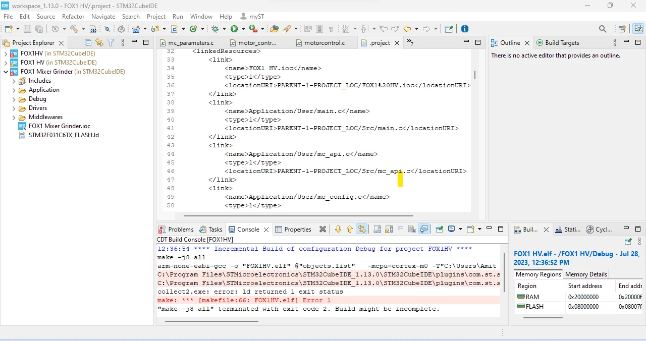

I am trying to build the code on STM32CUBE IDE Version: 1.13.0. This code for evspin32f0601s1 is generated by CubeMX.
It is throwing up 3 errors as below:
C:\Program Files\STMicroelectronics\STM32CubeIDE_1.13.0\STM32CubeIDE\plugins\com.st.stm32cube.ide.mcu.externaltools.gnu-tools-for-stm32.11.3.rel1.win32_1.1.0.202305231506\tools\arm-none-eabi\bin\ld.exe: FOX1HV.elf section `._user_heap_stack' will not fit in region `RAM'
C:\Program Files\STMicroelectronics\STM32CubeIDE_1.13.0\STM32CubeIDE\plugins\com.st.stm32cube.ide.mcu.externaltools.gnu-tools-for-stm32.11.3.rel1.win32_1.1.0.202305231506\tools\arm-none-eabi\bin\ld.exe: region `RAM' overflowed by 16 bytes
make: *** [makefile:66: FOX1HV.elf] Error 1
Any solution for this?

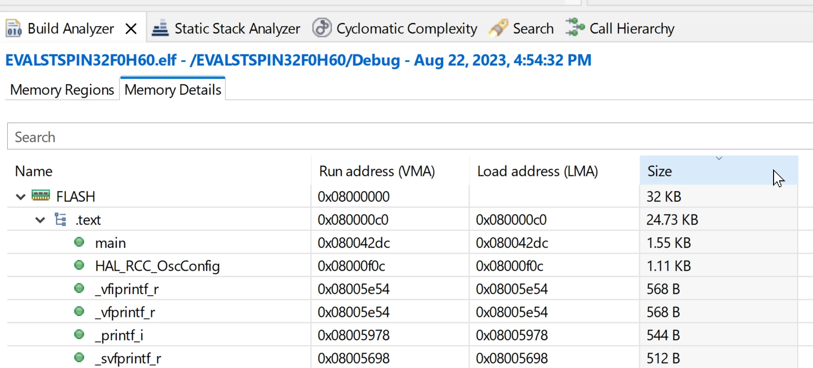

    August 22, 2023
    I compile EVALSTSPIN32F0H60 example using STM32CubeIde and following setup to save space on flash/ram:
    • On linker file size are:
    /* Entry Point */
    ENTRY(Reset_Handler)
    /* Highest address of the user mode stack */
    _estack = ORIGIN(RAM) + LENGTH(RAM); /* end of "RAM" Ram type memory */
    _Min_Heap_Size = 0x200; /* required amount of heap */
    _Min_Stack_Size = 0x400; /* required amount of stack */
    /* Memories definition */
    MEMORY
    RAM (xrw) : ORIGIN = 0x20000000, LENGTH = 4K
    FLASH (rx) : ORIGIN = 0x8000000, LENGTH = 32K
    • On Tool Settings / MCU GCC Compiler / Debugging: Debug Level = None
    • On Tool Settings / MCU GCC Compiler / Optimization: Optimization Level = Optimize more (-O2)
    This latest update is key to reduce RAM/FLASH size.
    If it still doesn't work on your side, try:
    • On Tool Settings / MCU GCC Compiler / Optimization: Optimization Level = None (-O0)
    If it still doesn't work, try to increase (For test purpose only!!!) RAM/FLASH/Heap/Stask:
    _Min_Heap_Size = 0x2000; /* required amount of heap */
    _Min_Stack_Size = 0x4000; /* required amount of stack */
    MEMORY
    RAM (xrw) : ORIGIN = 0x20000000, LENGTH = 256K
    FLASH (rx) : ORIGIN = 0x8000000, LENGTH = 256K

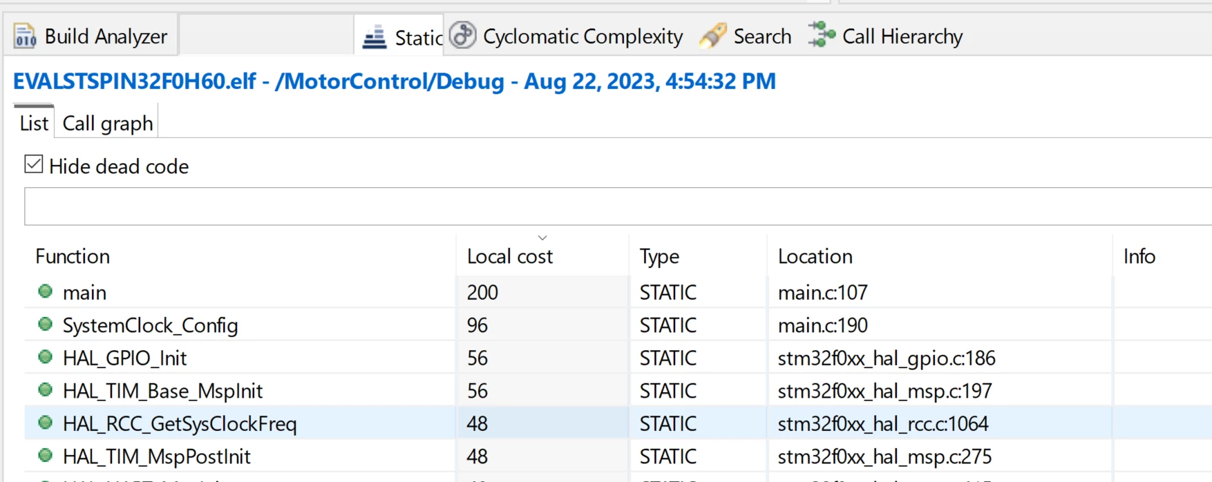

    After this, check and locate the culprit using "Build Analyzer" / "Memory Details" / Flash and Ram tools.
    It will help to understand where RAM/FLASH are used.
    When you will locate the culprit, and solved this size issue, came back to original FLASH/RAM setup.

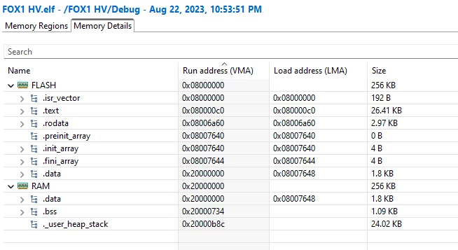

    Amit GAuthor
    August 22, 2023
    I tried with the below setting:
    It compiled successfully, but I am still not able to figure out what needs to be changed?
