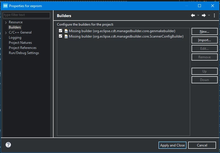

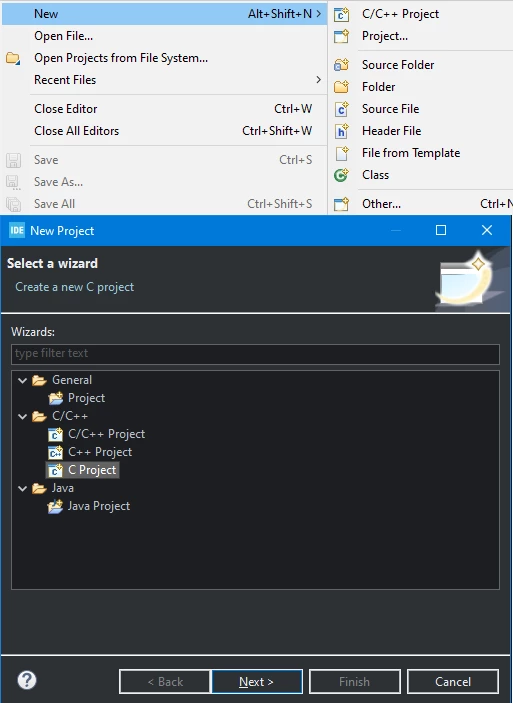

Everything is broken after 1.5.1 update (Also randomly deleting files! Warning!)
It worked fine 5 minutes ago. I was in v1.5.0.
I accepted the update, it installed correctly (apparently not), now I can't compile, create or edit any stm32 project.
All the existing projects show missing builders.
0693W000006GU5gQAG.pngCan't create stm32 project (the option is gone).
0693W000006GU5vQAG.pngCan't open any .ioc file (exception error).

6 replies
Cartu38 OpenDev
Graduate II
December 21, 2020
Sounds like exactly same as Error unknown nature on STM32Cube IDE after update
Are your using EGit ?
Best you have to do is to install fresh 1.5.0 then accept update to 1.5.1. Then right time to add extra contributions.
DavidAlfa
DavidAlfaAuthor
Senior II
December 21, 2020
Yes. I tried also that way, deleting everything, installing 1.5.0, upgrading to 1.5.1 and then installing egit.
3 times it crashed again.
At the 4th, it seems it worked this way:
Installed fresh 1.5.0. Opened. Closed. Opened and try to build. OK.
Updated to 1.5.1. Opened. Closed. Opened and try to build. OK.
Installed eGit. Opened. Closed. Opened and try to build. OK.
I have no idea what the bug is. But it seems taking extra care between steps made it work.
Tip: Backup the whole C:\ST folder before updating or installing anything, because it didn't fix when unistalling eGit.
I had to remove everything every time.

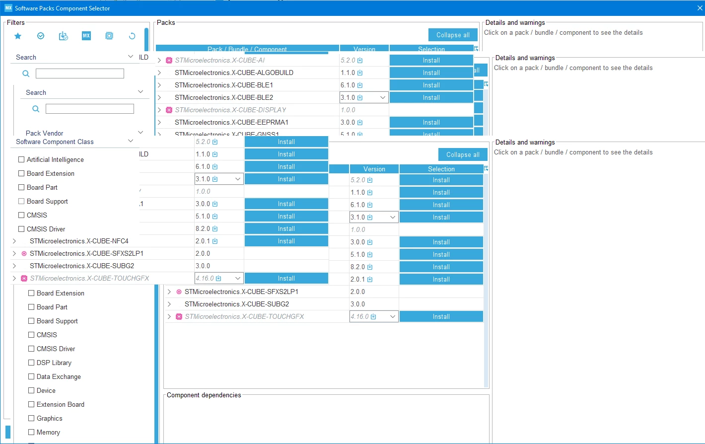

Also the CubeMX software manager appear totally distorted and broken,0693W000006HJ2xQAG.png
DavidAlfa
DavidAlfaAuthor
Senior II
January 4, 2021
Well. Totally erradicating Java and every **ST** file/folder in the hard drive and reinstalling everything, seems to finally solve the problems.
