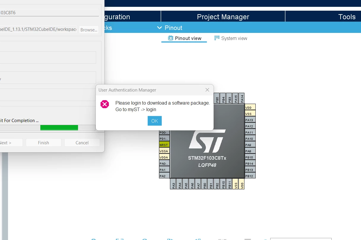

even after logging in, I get the error pls login to download software package. what am i missing?

here is the pic , how to login successfully so that I can download packages and work with the code ide software efficiently?

    Could you please try to follow those steps then provide the STM32CubeMX.log:
    - Delete user/.Stm32CubeMx
    - Run STM32CubeMx 6.9.1
    -Click on MyST-->login
    -Click on Help -->Updater settings -->Connection parameters --> then check your connection
    I will be waiting for your feedback.
    Thx
