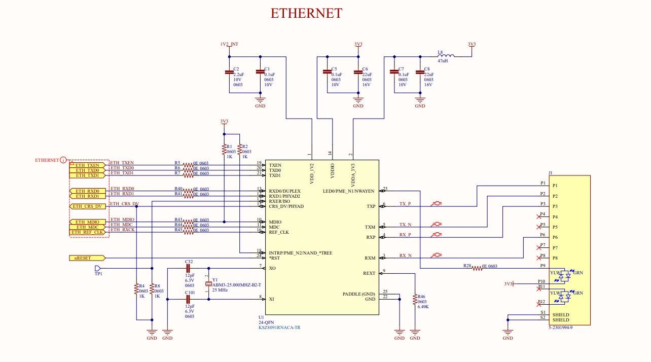

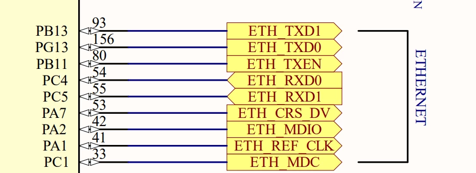

Assistance Needed: Ethernet Configuration Issue on STM32F429IIT6
I'm encountering difficulties in enabling Ethernet functionality on the STM32F429IIT6 board. Despite efforts, I can't ping the Ethernet connection. Could you provide example code or guidelines for configuring Ethernet? I'll also attach the pin connection and schematic for review. Your prompt assistance would be greatly appreciated.

    mƎALLEm
    LWIP examples here: https://github.com/STMicroelectronics/STM32CubeF4/tree/master/Projects/STM324x9I_EVAL/Applications/LwIP
    Schematics of the board (STM32F429-EVAL) using ETH MII mode: https://www.st.com/resource/en/schematic_pack/mb1045-f429nih6-b08_schematic.pdf
    AkshayK47Author
    I'm currently working with an RMII configuration and trying to integrate FreeRTOS into my system, but I'm still unable to establish a ping connection with the board.
