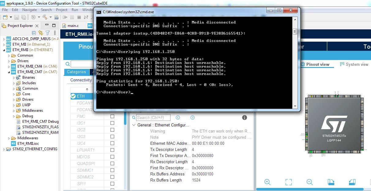

Ethernet in Nucleo H745ZI-Q
Hello, I have a Nucleo H745ZI-Q  board  in this am working Ethernet fallowed some examples when doing ping test response is Destination host unreachable(am using CM7 and  done memory configuration also).RMII.jpj.png

    Hello again @sa_it V.1,
    You can find all H7-related examples here: https://github.com/STMicroelectronics/STM32CubeH7
     For an Ethernet / LwIP example check this link: https://github.com/stm32-hotspot/STM32H7-LwIP-Examples
    This thread could also be helpful!

    Hello @sa_it V.1,
    It is recommended to follow the same configuration as in the examples provided in the STM32CubeH7 firmware package
    Also, check this FAQ :  https://community.st.com/s/article/FAQ-Ethernet-not-working-on-STM32H7x3
    Hope that helps!

    Am using STM32Cube IDE  v1.10.0   Where could i findout the exmples ? Can you specify the path to reachout the examples ....
    Sarra.SBest answer
    August 29, 2023

     Ethernet configuration and ping test done . Ping Test successfully ping's .Next i want send data from PC to Board  or  receive data  How and where should i process(in code - function )the data and how should i achive .  checking ping test in command prompt .
