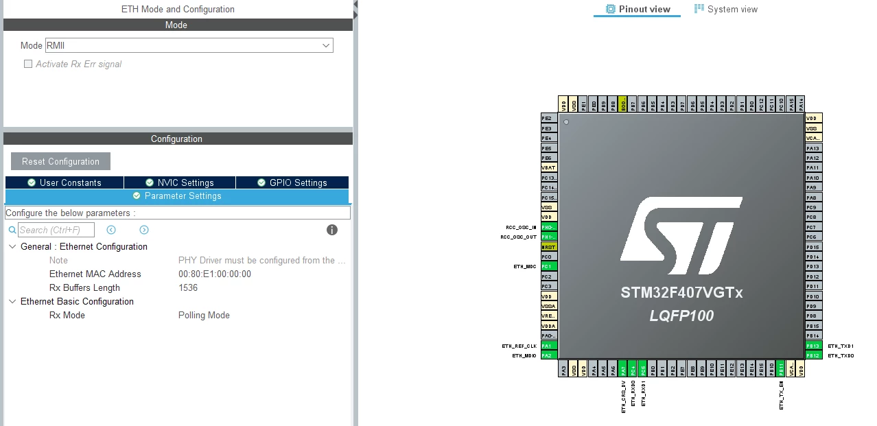

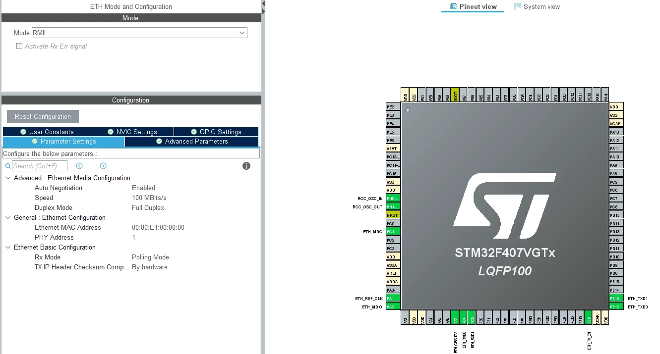

Hi, I have a problem. when I used old cube ide version, ı can changing physical address and ethernet module is to take ip address. But when I use new version I want to edit phy address but this area is not in new version.
That's why I can't use the Ethernet module in the new version.

Old Version Stm32Cubeide
New Version Stm32cubeide

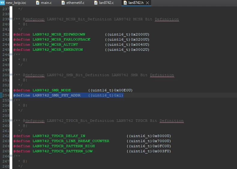

For now, I updated the value of this constant to 0x1 and the module was able to get the IP address. However, when I generate my code with different changes, I need to change the constant again.

I couldn't find any solution other than the one in the screenshot above
