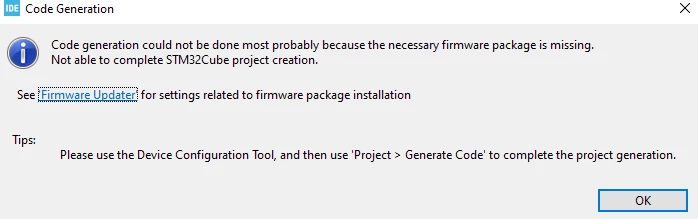

I am unable to generate the code with STcubeIDE for STM32H747I, will any one help me to sort this issue.
Version Details:
STcubeIDE : 1.13.1
CubeMX: 6.9.1
The error message is attached below

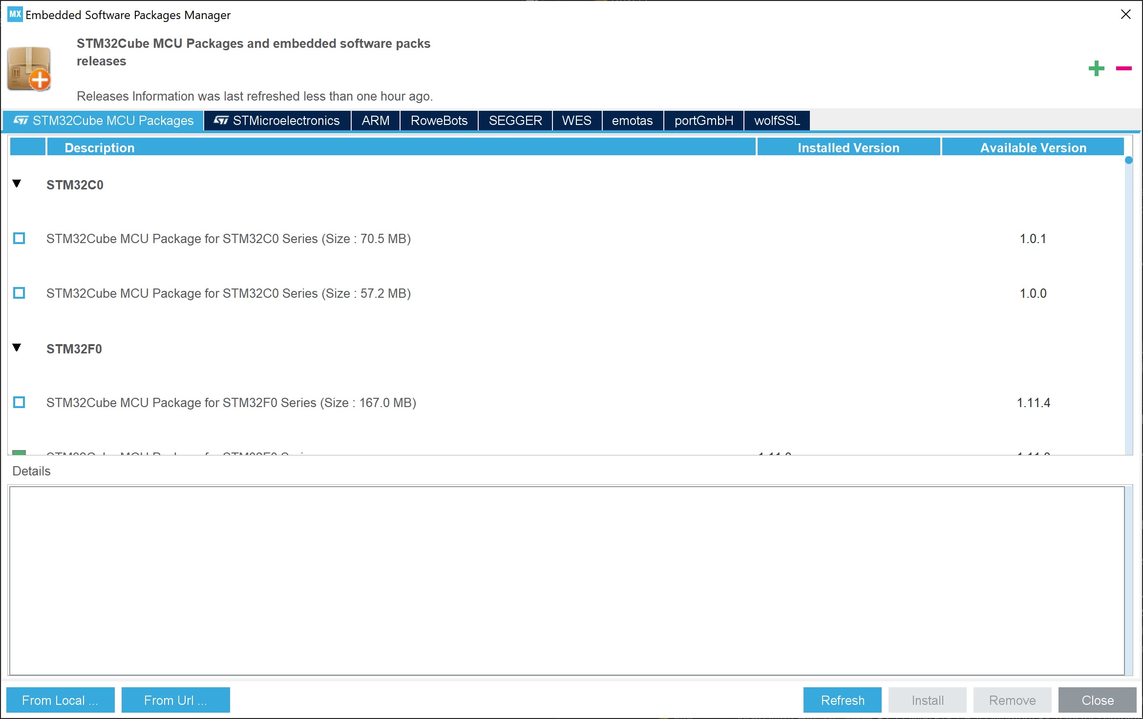

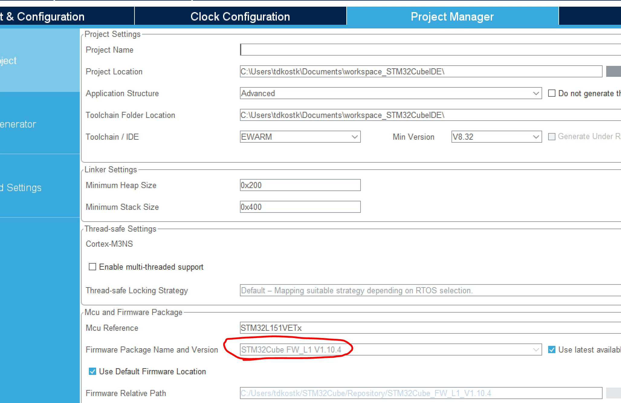

Open your IOC file, go to Project Manager and look at what firmware package it wants to use:
Then go to help -> Manage embedded software packages and download that package.

Hi TDK,
I confirmed that the relevant package is installed, and in the CubeMX it is showing as available.
Is there any other check?

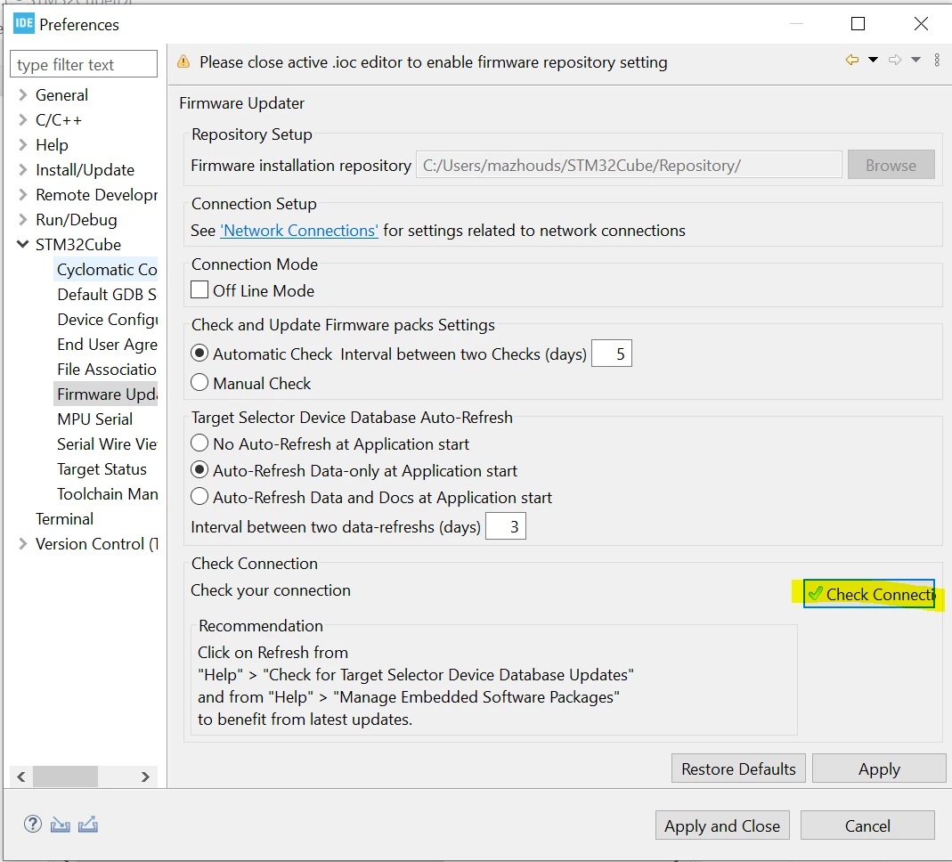

August 17, 2023
Hi @Shyam1
Thank you for posting!
please check the connection (Preference>STM32Cube>Firmware updater)
Regards
