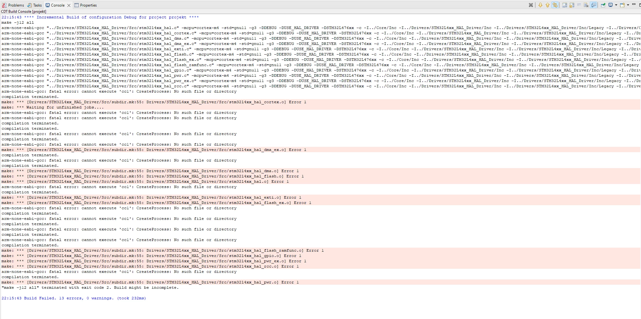

Errors while compiling empty project
Hi. When I create SMT32 project (I'm using NUCLEO-L476RG) and then I compiled empty project I recive same 13 errors all the time(look photo below). I really can't fix it and I can't find the solution.
What I tried:
  •  Reinstall STM32CubeIDE, didn't work
  • I tried the same on my other computer and it didn't work.
  • Install GNU Arm Embedded Toolchain, didn't work
Thanks,
Eryk

    Check if the same errors happen using STM32CubeIDE v1.12.1
    erysvAuthor
    August 12, 2023
    Tried, didn't work :\

    cc1 is an internal part of the arm-none-eabi-gcc compiler and the error says that cc1 was not found. Check that you STM32CubeIDE installation and your project paths are short and easy and do not contain spaces " ", umlauts, or other special ASCII or non-ASCII chars. Check also that you don't have multiple versions of the compiler tools installed or on the path.
    hth

    Also checked everything. Path for project and STMCubeIDE is short enough and simple. I checked if I have multiple versions of compiler tools installed and here everything is also fine. This is so enigmatic...

    There might be another compiler instance on the path , interfering. You may set in the Project Properties, C/C++ Build Settings, MCCU GCC Compiler Tool Settings the -v (verbose) flag to get some insight what's called. Sample output:

    The compiler tools are in the plugin folder of STM32CubeIDE like
    C:\ST\STM32CubeIDE\plugins\com.st.stm32cube.ide.mcu.externaltools.gnu-tools-for-stm32.11.3.rel1.win32_1.1.0.202305231506\tools\bin
     hth

    The compiler tools shall be in a folder like
    There may be other installed toolchains interfering.
    hth

    An irrational config.sys can produce strange errors. Use one from a simple GPIO HAL library example.
