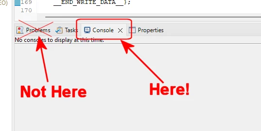

    @Abhesheksh wrote:
    my project has thrown up 100+ errors. It doesn't recognise "u_char" or "uint" or "caddr_t".
    It throws up error "expected ')' before 'GPIO_TypeDef'"
    That typically happens when there is one error early on in your code, and that one error is the cause of all the rest.
    So the thing to do is to go to the very first reported error - most likely, a missing or not-found header.
    "u_char" or "uint" or "caddr_t" are not standard types, so they must be defined somewhere in your code - presumably a header?
    And, presumably, that header is not being found?
    Clearly, that will cause every single use of any of these types anywhere in your code to fail - and you can see how that will quickly lead to loads of errors from just the one problem.
    You need to look in the build console output - not in the 'Problems' list:
