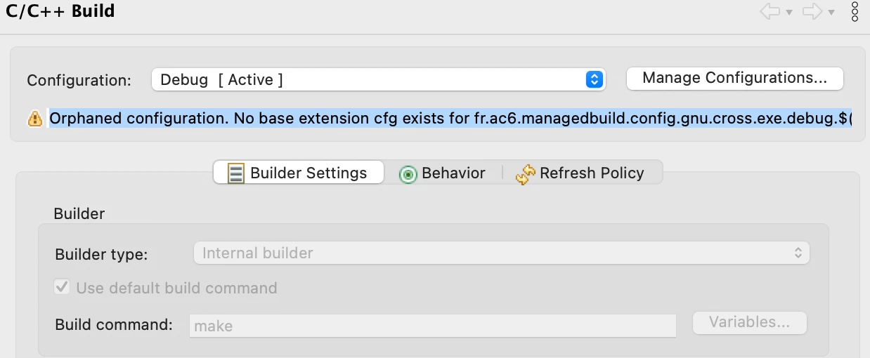

 Import seems to be successful but the build configuration seems to be faulty. The error I get is
"Errors occurred during the build.
Errors running builder 'CDT Builder' on project 'STM32F401RE-Nucleo Configuration'.
Internal error building project STM32F401RE-Nucleo Configuration configuration Debug
java.lang.NullPointerException
java.lang.NullPointerException"
In the build menu the following error is displayed.
0693W00000HqEwkQAF.pngIs there any fix for this or am I missing something obvious?

Hello @JLusk.1​ and welcome to the ST Community.
Try to copy the attached project in this folder: ...\Projects\Multi\Applications\MotorControl
where you have the project of all the other IDEs
Let me know if this solve the error

Hi, thanks for the reply.
There now are significantly fewer errors but there is still one instance where a file cannot be found, I don't know if it might be my specific install of stm32CubeIDE but in any case it cannot complete the build.
The error message is as follows:
make: *** No rule to make target '/.../STM32CubeExpansion_SPN11_V1.0.0/Drivers/STM32F4xx_HAL_Driver/Src/stm32f4xx_hal_mmc.c', needed by 'Drivers/STM32F4xx_HAL_Driver/stm32f4xx_hal_mmc.o'. Stop.
"make all" terminated with exit code 2. Build might be incomplete.
