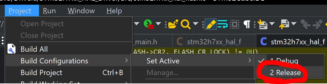

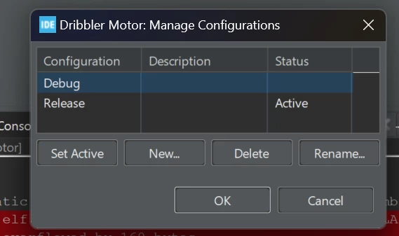

    Or consider using the Release configuration to build, which will get rid of large amounts of unused code and optimize the rest. The default Debug configuration keeps everything in there to aid with debugging.
    October 29, 2023
    Thank you so much for the fast reply. I tried using the Release build configuration but it still gets the same error
    October 29, 2023
    I optimized for size and it fixed the issue but what implications could this cause? Performance issues ? I am in the early stage of development trying to just evaluate design and investigation
