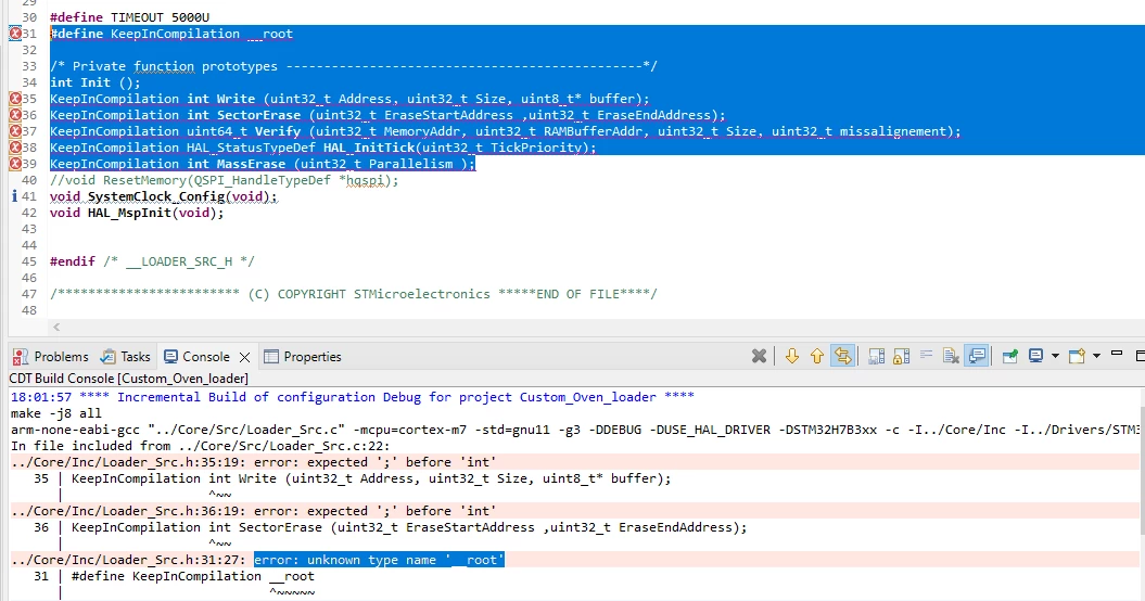

error: unknown type name '__root'
  • March 9, 2022
  • 11 replies
  • 8968 views
I am using below codes. But this define not supportted
#define KeepInCompilation __root
int Init ();
KeepInCompilation int Write (uint32_t Address, uint32_t Size, uint8_t* buffer);
KeepInCompilation int SectorErase (uint32_t EraseStartAddress ,uint32_t EraseEndAddress);
KeepInCompilation uint64_t Verify (uint32_t MemoryAddr, uint32_t RAMBufferAddr, uint32_t Size, uint32_t missalignement);
KeepInCompilation HAL_StatusTypeDef HAL_InitTick(uint32_t TickPriority);
KeepInCompilation int MassErase (uint32_t Parallelism );
Best answer by TDK
Why is this here at all?
After some searching, appears to be a macro for the IAR compiler. STM32CubeIDE uses GCC.
https://github.com/search?q=KeepInCompilation&type=code
Appears to be code that was blindly copy/pasted without the necessary #if statements.
https://github.com/chcbaram/stm32_ext_flash/blob/9724a4d5e393c3e84b7b190fcebe4269b21f5d2e/stm32h750_ext_flash_W25Q128FV/src/ap/Loader_Src.h#L20

Yes would typically be in an include file,
Whoever wrote this code must have had specific assumptions about the tools they were using, people lifting the code need to be aware of the tools that were used, and there exceptions, and adapt the code to work with their own tools, or use the more flexible definitions where it identifies a sub-set of common tools, and provides the appropriate directive.
The reason you need to "Keep" the entry points is that they aren't called internally, but need exporting externally as the loader is pulled in a bit like a DLL, and has multiple entry points, and isn't using main(), or the C run-time initialization methods.

"KeeInCompilation" macro is a misnomer. The intent is to keep the thing in the final image (after linking - not compilation!)
How this is implemented depends on the toolchain. For the IAR compiler this should be defined as "__root" and it is somehow passed to the linker. The GNU compiler knows attributes "used" and "unused" but these do not propagate to the linker (or the linker ignores them, I don't know). So for GNU toolchain, we change the linker script and define KeeInCompilation as nothing (better rename it to something more appropriate).

@FLuba.1 Examples were pointed by Tesla earlier in this and other threads. Basically you (a) put the needed functions in a custom section and (b) define this section in the linker script, in appropriate place, with attribute KEEP. This tells the linker not to discard that code as unused, AND place the code in specific way. But problem in your loader can be caused by something else. What exactly it is? Post a new thread, please.

As I said, I address this in the Linker Script, by establishing the symbols I want to retain and export.
https://github.com/cturvey/stm32extldr/blob/main/ExternalLoader.ld#L43
Whereas KeepInCompilation is a tool chain specific macro to flag to the linker, by way of the compiler, that a function is used somewhere, and thus not subject to dead-code-removal. You can check the exports/symbols with tools like objcopy or fromelf
#ifdef __ICCARM__ // IAR
#elif __CC_ARM // MDK-ARM V5.xx
#define KeepInCompilation __attribute__((used))
#elif __clang__ // MDK-ARM V6.xx
#elif TASKING // TrueStudio
#elif defined(__GNUC__)
#endif
ST has some specific expectations with .ELF / .STLDR object files. Typically they are not going to use main() and an entry point, there's not startup.s code to clear or move static initializations, and there's no expectation of an interrupt vector table. The StorageInfo struct has specific size, content and placement expectations too.
