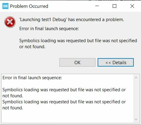

Hi everyone,
After using IAR and Keil for several years, i decided to try STM32IDE.
I generated an initialization code using STM32cubemx, and used STM32IDE for compiling and programming my STM32 board. However, it generated an error and was not able to enter debugging mode.
I tried the same initialization code with IAR, and it worked fine.
Does anyone knows what is wrong with the debugging on STM32IDE? any specific configuration needed?
Thanks,

AJafa.2
AJafa.2Author
October 6, 2020
The error message screenshot is attached.

AJafa.2
AJafa.2Author
October 9, 2020
Hi Markus,
Thanks for your response,
Actually, i am aware of the fact that the generated code for IAR and STM32cubeIDE would be different when CubeMX tool is used. i meant that when i only change the target IDE from the CubeMX setting, the very same setting results in this issue in STM32CubeIDE.
please find attached the project file, this compiles without any error, but when i try to enter debug mode i get that error.
Thanks,
Ali
Markus GIRDLAND
October 13, 2020
I tried your project and I switched debug level to none and then default value (-g) and then it worked. So then I tried to switch back to Maximum (-g3) and then it works on that level as well, so I'm currently doing some more investigation into it but that at least allowed me to get started with the debugging of that project.
Try it out and see if it works for you as well. You change the setting by right clicking the project and selecting Properties -> C/C++ Build -> Settings -> Tool Settings (tab) -> MCU GCC Compiler -> Debugging -> Debug level
