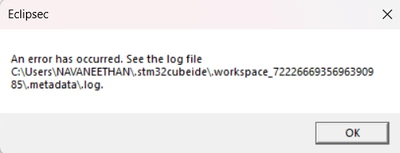

Error occurred while regenerating the project in STM32CubeMX 6.13.0 after adding a custom folder path.
I'm using STM323H755ZIT6 NUCLEO board, STM32CubeMX 6.13.0 and STM32CubeIDE 1.17.0.
In my scenario, I created a project in STM32CubeMX 6.13.0 and generated the project. After that, I opened this project in STM32CubeIDE 1.17.0 and added paths for external folders in Paths and Symbols. Later, I edited the .IOC file in STM32CubeMX and tried to regenerate the project, but an error popup appeared.
ERROR POPUP
After this popup, I clicked the OK button, and STM32CubeMX showed 'Project Successfully Generated.' However, when I tried to build the project in STM32CubeIDE, it failed to build, and errors appeared, such as:

Feb 14, 2025 4:28 AM UTC
The file ..\STM32CubeIDE\.project needs to be removed. Reopening the project in STM32CubeMX and regenerating the code will resolve the mentioned issue.
