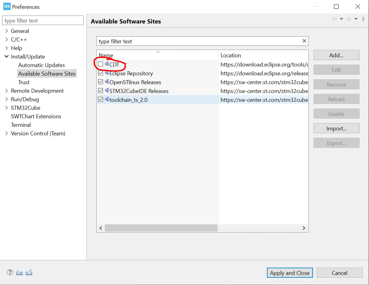

Hello there!
I'm fairly certain that you are facing the new issue that my colleague Mattias is mentioning in this thread:
https://community.st.com/s/question/0D53W00001zeSZcSAM/stm32cubeide-intool-update-issue
It might work if you remove CDT from the available software sites:
We are currently investigating this issue further!

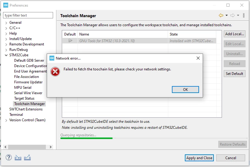

FRieb.1
FRieb.1Author
December 14, 2022
Thank you for your reply.
I have tested your suggestion but at the moment I always get the error shown below.
I have already tried this on a connection without proxy and anti-virus but the result is still the same.
If I understand it right, the updates have been stopped for the moment. My assumption is that it is related to this.
Markus GIRDLAND
December 14, 2022
Yes, for now we have stopped most ways to update in order to stop users from accidentally breaking their installations. I'll be sure to update here if we find another safer way to do updates. Sorry for the trouble!
