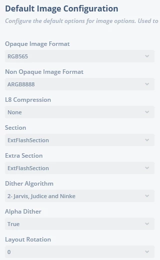

TouchGFX default image configuration are shown below. All images used the default or ARG8888 or RGB888

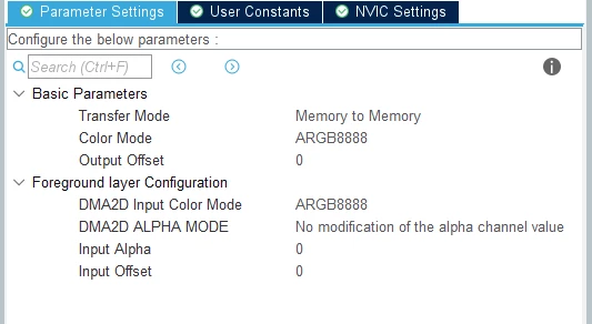

In CubeMX the DMA2D is set as follows:

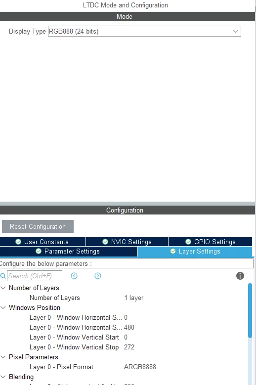

and LTDC settings:

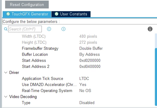

and finally TouchGFX settings in CubeMX:

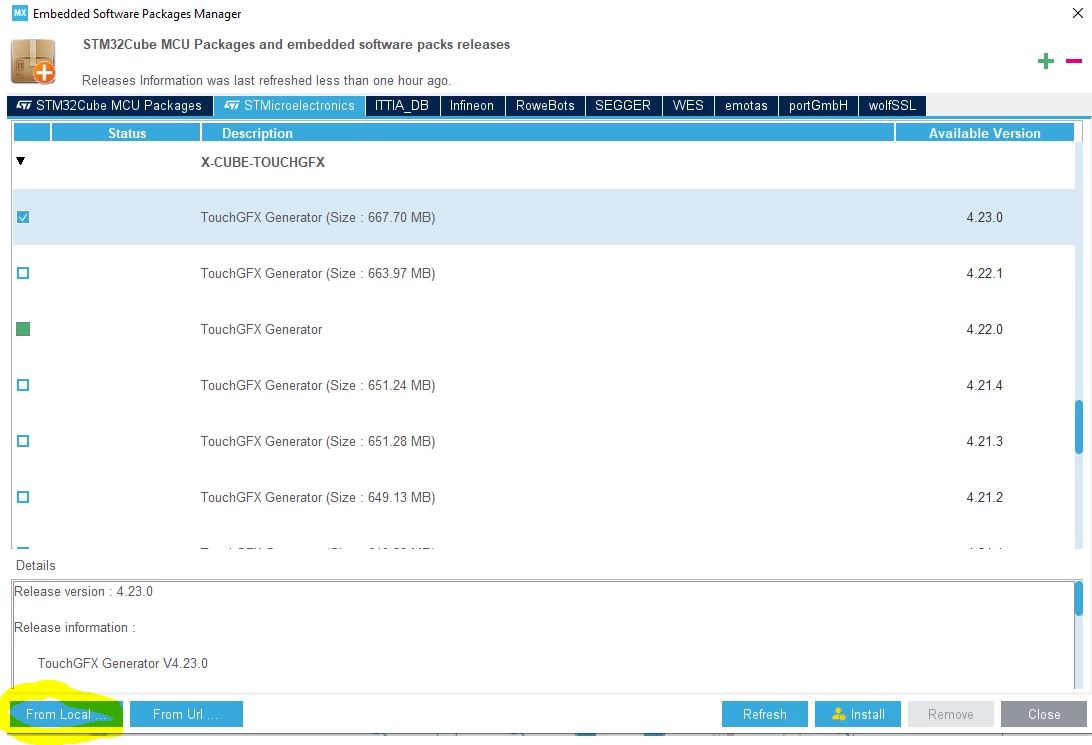

    Try download and install the X-CUBE-TouchGFX manually into STM32CubeMX.
    After download the package, you need to install it by using "From local" option in the Help >> "Manage Embedded Software Packages" option in STM32CubeMX (please see the screenshot below - "From local" option in the bottom left, with yellow color).
    Then, select the X-CUBE-TOUCHGFX package (zip folder).
    Hope this works for you!

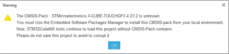

    I uninstalled CubeMX, TouchGFX and CubeIDE and started over.  I got a good compile.  However when I go back into the .ioc file I get the following message:
    The embedded software packages manager and Software packs selector has TouchGFX4.23.0 but does not seem to like TouchGFX v 4.23.2 I have installed.  This seems to be the root of the problem.

    I removed all the installed software and reinstalled and no difference.  I changed the Framebuffer Pixel Format in the TouchGFX Generator in CubeMX from XRGB8888 to ARGB8888 and the issue with undefined variables went away.
    There is still the issue with CubeMX not recognizing TouchGFX version 40.23.2.  You just cannot go back into CubeMX after generating code in TouchGFX version 4.23.2.

    Turns out the issue with undefined variables is caused by selecting XRGB8888 in the Framebuffer Pixel Format under the TouchGFX Generator in CubeMX.  Selecting ARG8888 fixed the undefined variables issue.

    Mar 27, 2024 10:44 AM UTC
    @Imen.D
    Thank you.  That solved the issue with CubeMX not recognizing TouchGFX version 40.23.2.
    Both issues have been resolved.
