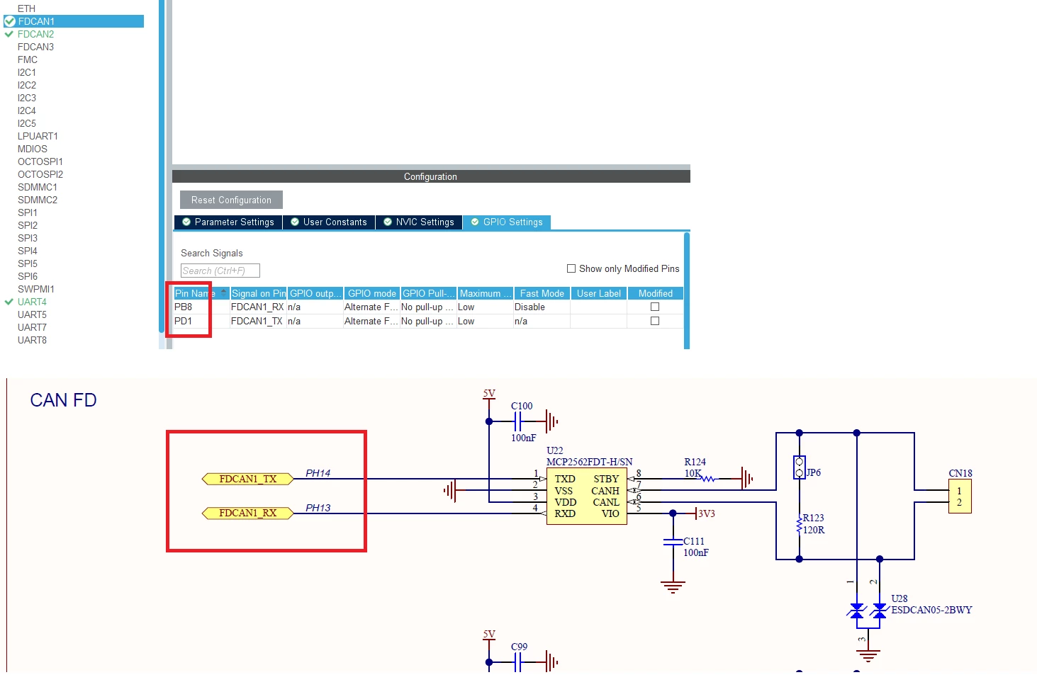

I've been following this video on YT on how to get the FDCAN on my discovery board (STM32H735G) to work: https://www.youtube.com/watch?v=sY1ie-CnOR0 . Note that this is the 2nd video of a series, if you want to watch it. Now, my problem is not with the video but with why the code doesn't work on my board. The full code you can find attached to this post.
The code compiles and runs without a problem, however, when I reach the
if (HAL_FDCAN_AddMessageToTxFifoQ(&hfdcan1, &TxHeader1, TxData1)!= HAL_OK)
line in the while(1) loop the second time around, it throws an error. I have been unable to identify what the error is or how to solve it, however, I had a look at the pins with an oscilloscope to confirm the existence of a signal or the lack thereof. I did not see a signal. What I find interesting is that it succeeds the first time but only gives an error the second time around.
Any insights and solutions are welcome!

After checking your .ioc file, you're configuring the wrong GPIO pins for FDCAN1 (PB8 & PD1):
According to the board schematics, you need to set:
PH13 for FDCAN1_Tx and PH14 FDCAN1_Rx.

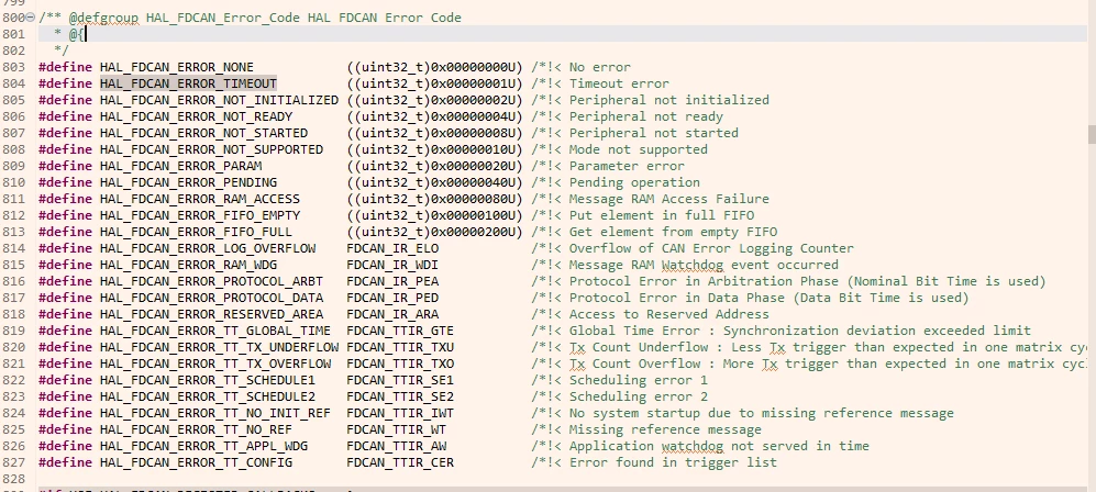

If there is an error, you can check it in the error callback.
void HAL_FDCAN_ErrorCallback(FDCAN_HandleTypeDef *hfdcan)
	uint32_t error;
	error = HAL_FDCAN_GetError(hfdcan);
If a reply has proven helpful, click on Accept as Solution so that it'll show at top of the post.CAN Jammer an open source CAN bus hacking toolCANableV3 Open Source
Thank you for the advice! I implemented your code and was able to see the error code: 512 (HAL_FDCAN_ERROR_FIFO_FULL). Any idea what could be the cause of it? How do I solve it?
