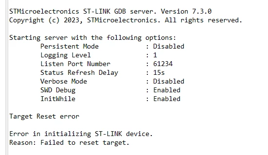

Error in initializing ST-LINK device. Reason: Failed to reset target.
Hi.
I made 3~4 F401RTCU boards and have no problem.
But, last board cannot use STM32CUBEIDE debug mode.
Target reset error is occurred.
I can program hex to this board by st-link utility but stm32cubeide cannot debug this board.
This error comes from H/W problem?
Reset circuit looks no problem, I use normal reset circuit. R/C circuit.
Please help me.

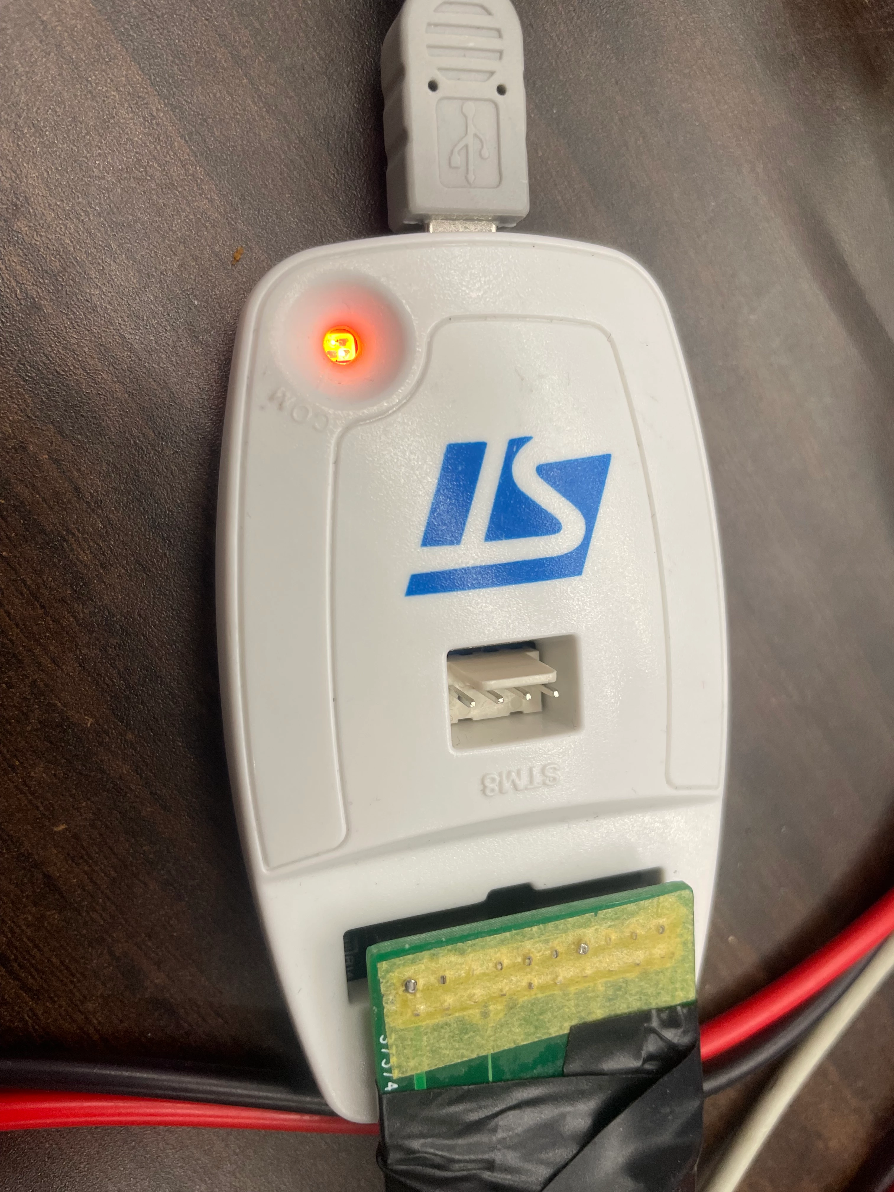

    Peter BENSCH
    November 15, 2023
    Can you please show us a photo of your ST-LINK?
    Regards
    /Peter
    Paul.Lee
    Paul.LeeAuthor
    November 15, 2023
    I attached my st-link
    With this, I can do debug other F401 board now.
    But, for last board, I cannot.

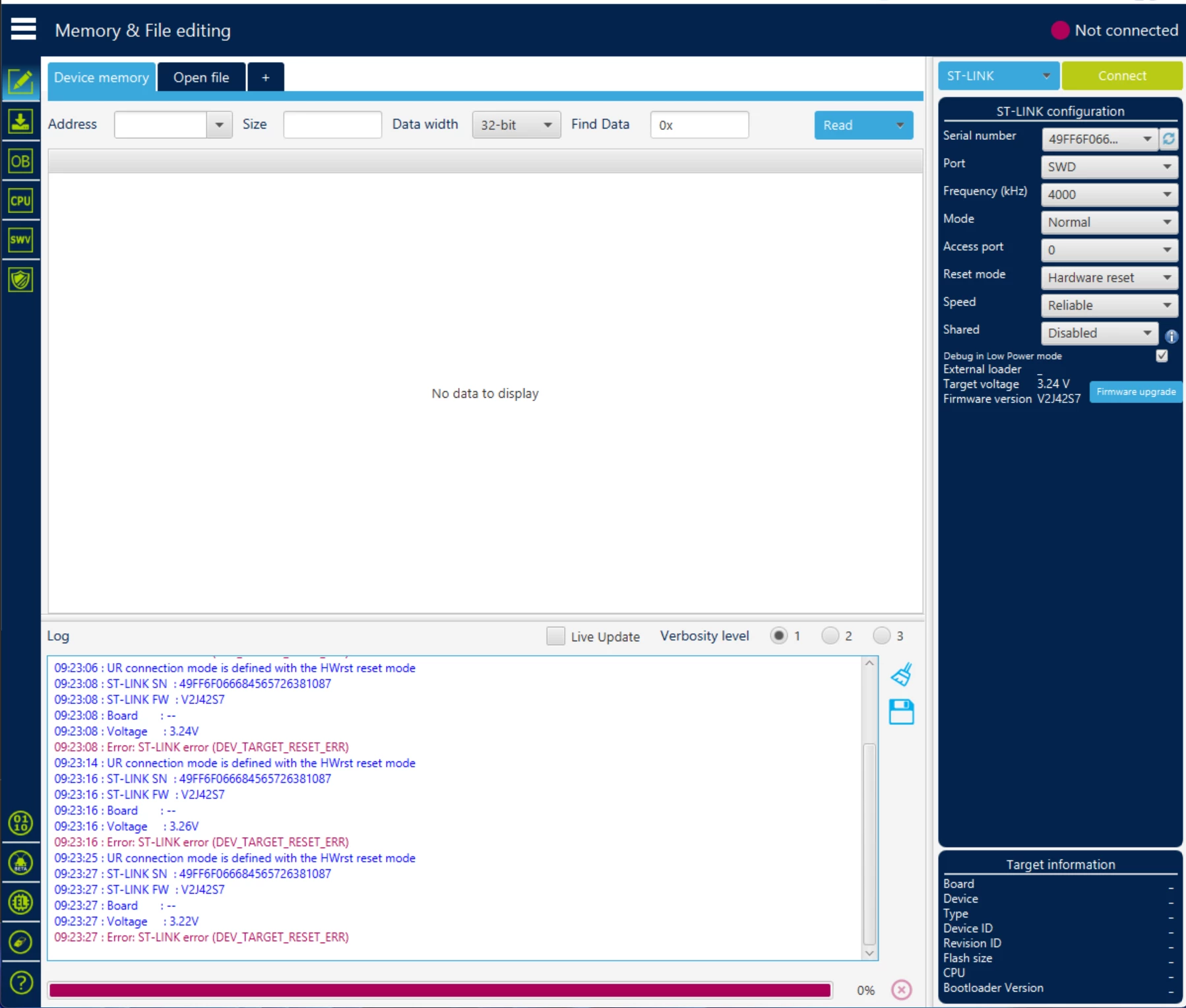

    Paul.Lee
    Paul.LeeAuthor
    November 17, 2023
    I update the STM32CubeProg, but same error.
    What point do I have to check, H/W?
