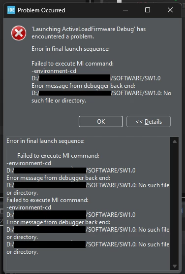

I have a problem while I'm trying to upload the firmware (the same while I'm trying to debug), I'm working on a project located in a folder that is not the default workspace folder.
As you can see in the image below, when I press debug or run, this error message appears:
When I try to compile and debug a project on the default workspace everything goes fine, this only happens when I'm on a project in a non-default location.

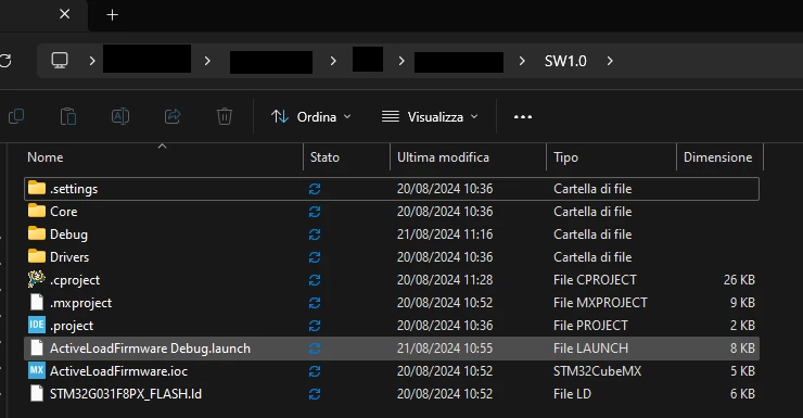

I have checked after building the project (which works fine) that all the debug files are generated and they are.
Can anyone help me?
Thank you!

    Does your path have spaces or non-ASCII characters in it? Build tools do not play well with these.

    Thank you for your reply,
    The only special character is an "À" in a folder name.
    I just tried to replace it with an "A" and it works.
    Thank you so much! It was easier than I expected.
