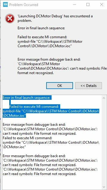

Error in final launch sequence: Failed to execute MI command: symbol-file "C:\\Workspace\\STM Motor Control\\DCMotor\\DCMotor.ioc"
I'm trying to debug STEVAL$STSPIN3202 motor control board. I have generated code by using motor control workbench. I compile the code without anyproblem, but i recieve attached error message.
I'll be glad to get your support.

??? how can you initiate some debug session based on .ioc file ? Such file is not target device compliant at all file ... Please have a new try based on .elf or .hex or .bin file ...

I have solved the problem. I have changed the language to English. That was the prblem👷
