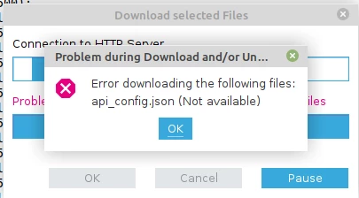

Today, when I try to create a new project from an existing STM32CubeMX configuration file (ioc), I get two errors.
Clicking Ok, CubeIde show the menu for selecting project, and seems like nothing happened.
Can I trust projects created this way?

Are you logged in, in IDE menu... ?
Because if not logged in, I got same error.

Hello,  @AScha.3
Please, how you log in CubeIDE. I don't found, and CubeIDE don't ask me.
CubeIDE was running with no errors when I Accepted as solution, but now I have the same the same problem again.

Hello,  @AScha.3
Yesterday I went to the other town to test it, and I had the same problem.
Now, I'm in my habitual city, and I have no errors.
I've noticed that CubeIDE now doesn't ask me for the password, so the problem is probably what you described.

Hi,  @xisco
Go in IDE menu-> Help -> stm32Cube updates -> connection to stm -> enter account ... (accept cookies...)
is your name/pass as here , then you get access ... try.

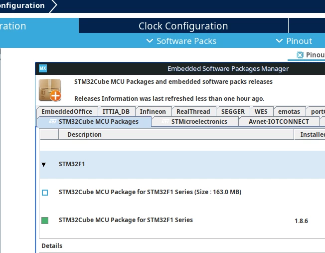

Maybe need update the software package for the cpu series you want to use , in IDE Cube ->
software -> manage ...
