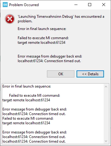

after upgrading from 1.12.1 to 1.13.1 I encounter the following problem when trying to download my (previously working fine) project onto STM32:
Any ideas?
regards

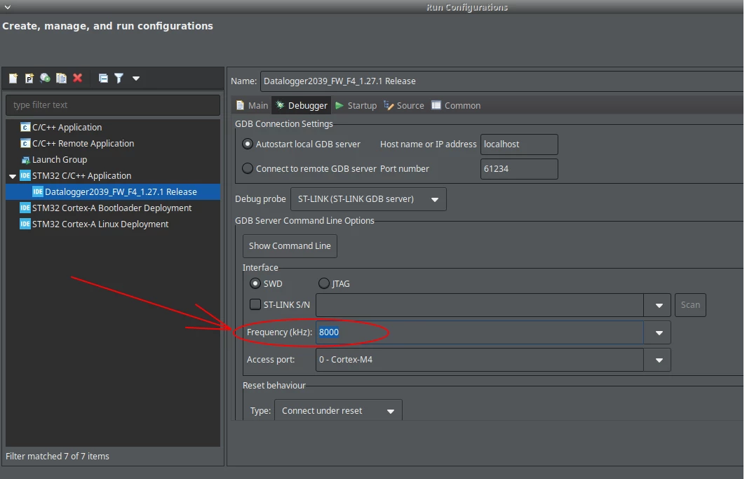

Try reverting back to version 1.12.1, this problem may be related to the ST-link frequency above 1000kHz.

herbert
herbertAuthor
August 28, 2023
Hello @Rim LANDOLSI,
thanks, your tip to Check Connection with the Firmware Updater did set me to the right direction, as this also suggested to go to Help->Check for Target Selector Device Database Updates, which then did the trick for me and I was again able to connect to my STM32F411 board.
regards Herbert
