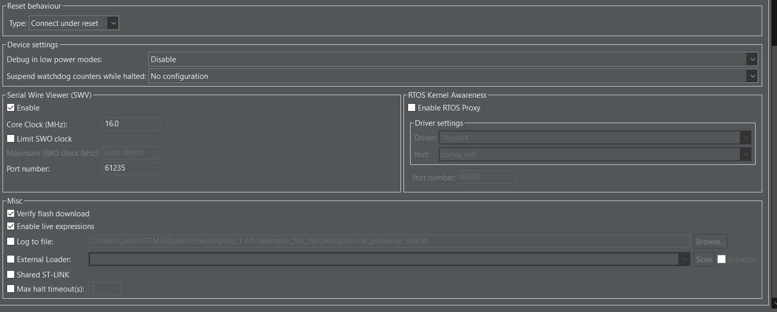

jreis.1
jreis.1Author
January 31, 2023
0693W00000Y9eF5QAJ.png0693W00000Y9eFyQAJ.pngHi! Here it is the debug configuration. How can i get the debug log? Thanks in advance!

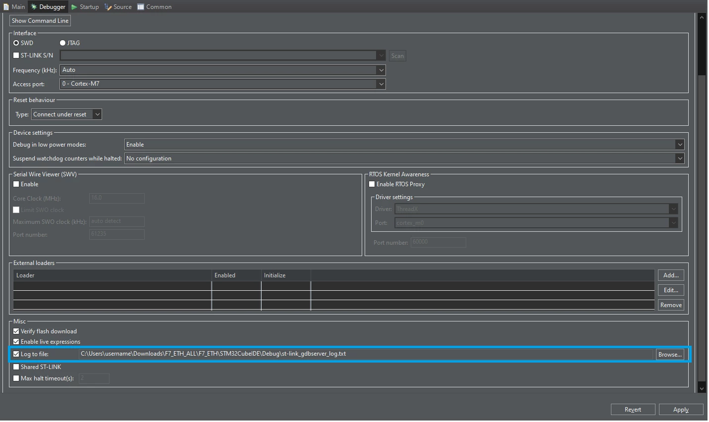

Semer CHERNI
February 1, 2023
Hello @jreis.1​
My bad I should have put a description on how to get the debug log.
Under the debug configuration -> Debugger check the log to file option as shown in the screenshots:
Kind regards,
Semer.
