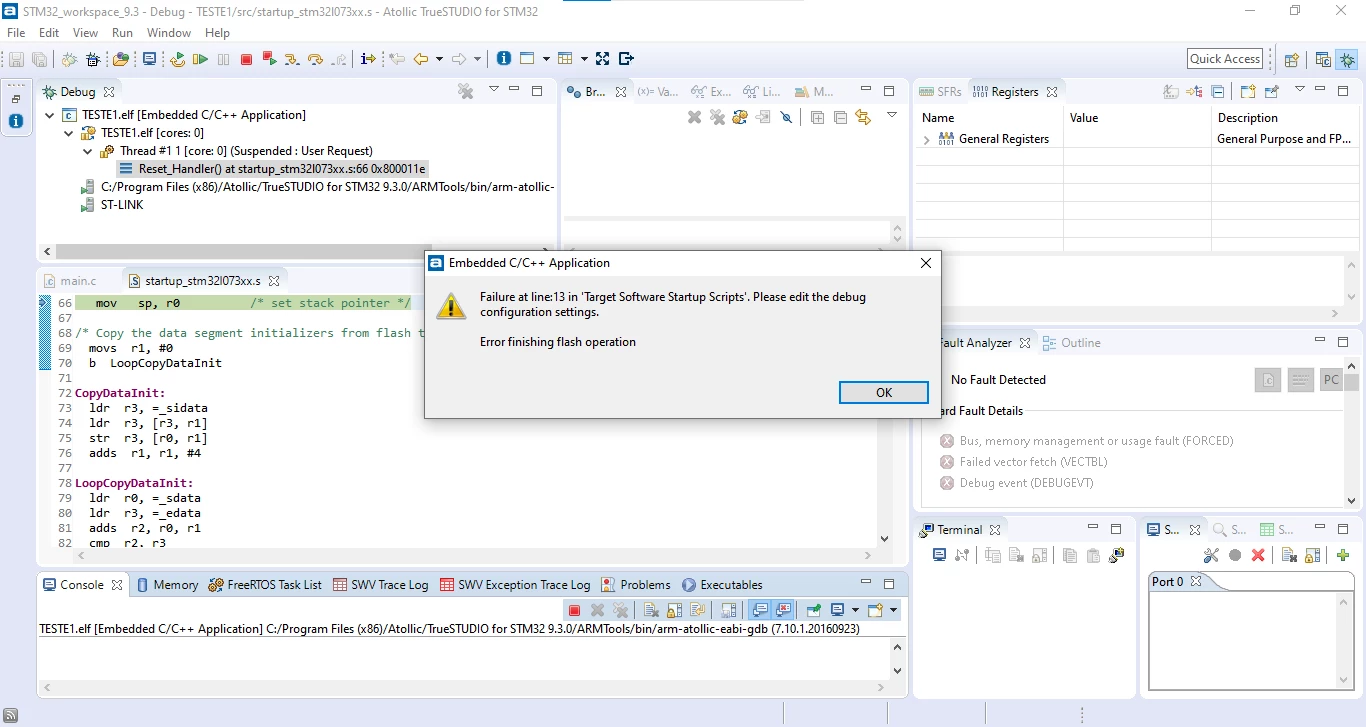

Error during debugging - Failure at line: 13 in 'Target Software Startup Scripsts'.
Hey guys
I am having a problem with my NUCLEO-L073RZ approval board and would like to ask your help:
I use Atollic Truestudio for programming and debugging my NUCLEO board. When I plug in the board and start debugging, it returns the following error:

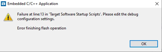

Please edit the debug configuration settings
Error finishing flash operation .
I've tried erasing the flash using the ST-LINK Utility, but it keeps giving the same error. I've also uninstalled Atollic Truestudio and formatted the computer and I couldn't solve this problem either. Another important point to highlight is that when I use STMCUBEIDE and debugging happens normally without errors.
Debug Settings
# Set flash parallelism mode to 32, 16, or 8 bit when using STM32 F2/F4 microcontrollers
# Uncomment next line, 2=32 bit, 1=16 bit and 0=8 bit parallelism mode
#monitor flash set_parallelism_mode 2
# Set character encoding
set host-charset CP1252
set target-charset CP1252
# Reset to known state
monitor reset
# Load the program executable
load
# Reset the chip to get to a known state. Remove "monitor reset" command
# if the code is not located at default address and does not run by reset.
monitor reset
# Enable Debug connection in low power modes (DBGMCU->CR)
set *0xE0042004 = (*0xE0042004) | 0x7
# Set a breakpoint at main().
tbreak main
# Run to the breakpoint.
continue
Thank you all.
