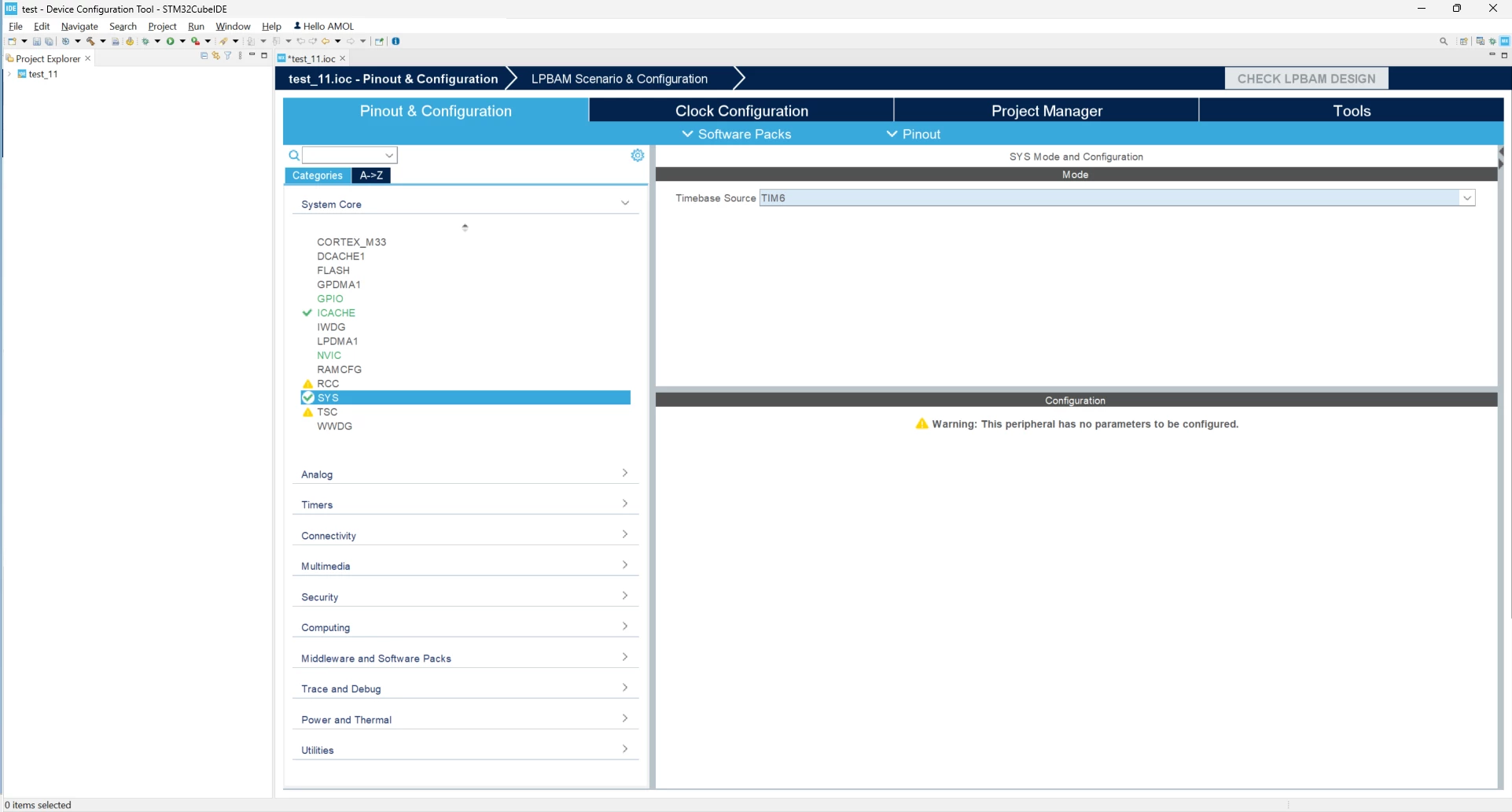

I am creating project using STM32CUBEMX for board (B-U585I-IOT02A) Non-Trust-Zone.
the above configuration done while creating project.
I am getting stuck at HardFault_Handler.
am I missing some configuration, please let me know !!

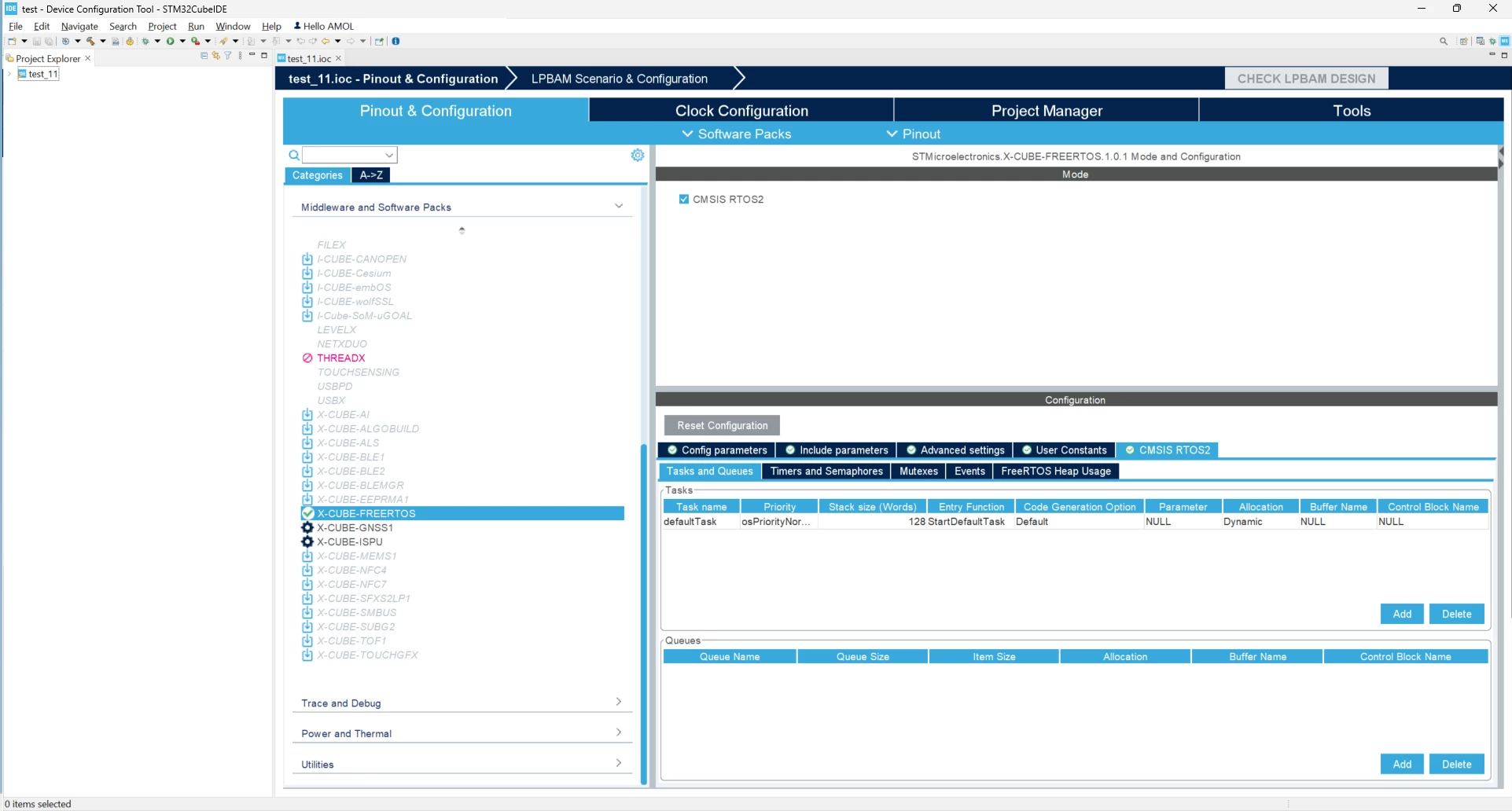

    Thanks for reply
    I am debugging the code through cubeide and it redirects to
    osKernelStart -> vTaskStartScheduler -> xPortStartScheduler -> vStartFirstTask
    July 27, 2023
    Probably insufficient heap or thread stack size.
    July 27, 2023
    Could you please describe how to modify the stack and heap?
    currently I am using heap_4.c when created the project.
