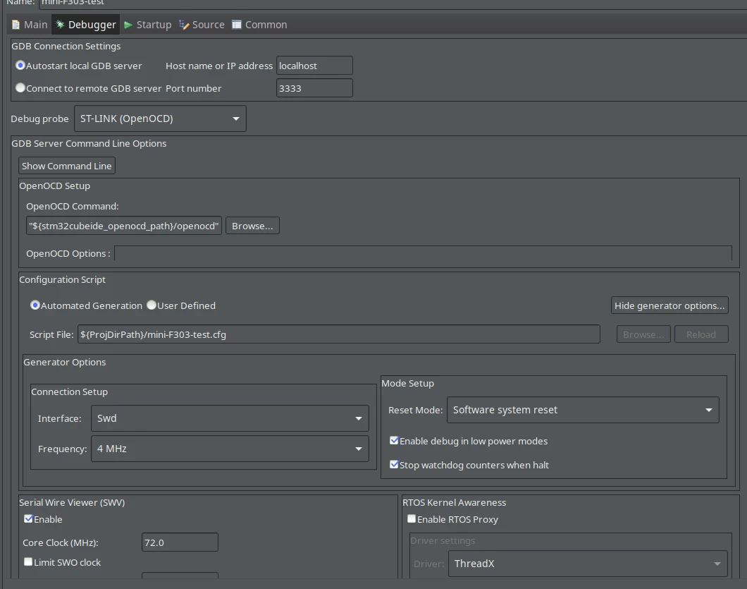

    well, i tried "your way" ... just get nothing than >hard fault. (on F303 cpu )
    on cubeIDE
    then removed some lines...then all.
    nothing from itm.
    using open ocd :
    so removed all , again set only:
    /* USER CODE BEGIN 4 */
    int __io_putchar(int ch)
     ITM_SendChar(ch);
     return (ch);
    with:
    then it worked...
    try it. (but i can promise, it is more hit and hope game ! )

    Tested and working on H5 (563), H7 (733, 743, 7A3) :
    I have just enabled SWD+SWo in Cube, then in debug settings also: enable SWV . + set correct core frequemcy, it will run.
    Then in main, just the
     ITM_SendChar(ch);
     return (ch);
    In debug session then, pause, select SWV, ...as you show it on top. + "start trace" .
    Then its working, thats all.
