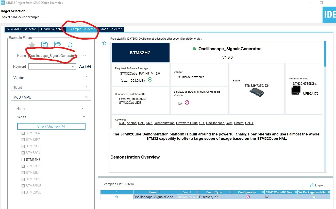

I am Directly Open the Example Project in CubeIDE

Cartu38 OpenDev
Graduate II
June 4, 2021
"I am Directly Open" ... please share snapshot of explain more "directly" .. there are numemous way to do ... my answer is depending of way :)

senthil
senthilAuthor
June 4, 2021
Double click the Project and this automatically add the workspace
Cartu38 OpenDev
Graduate II
June 4, 2021
Not sure about because according to me your way of working should be ok relying on this kind of example.
Weird stuff is you're getting trouble at debug time not compile time.
Just in case could you get a new try relying on File > Import > General > Import STM32Cube example
Let us know if helping or leading to same trouble.
