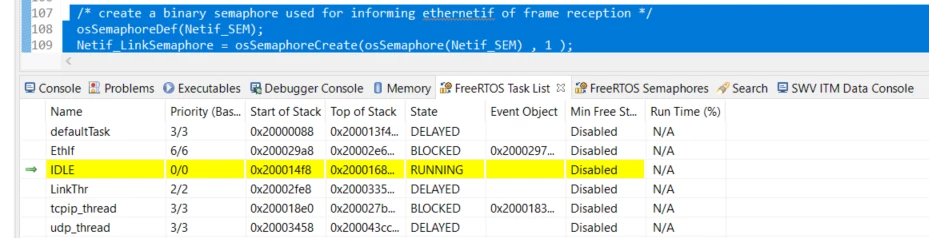

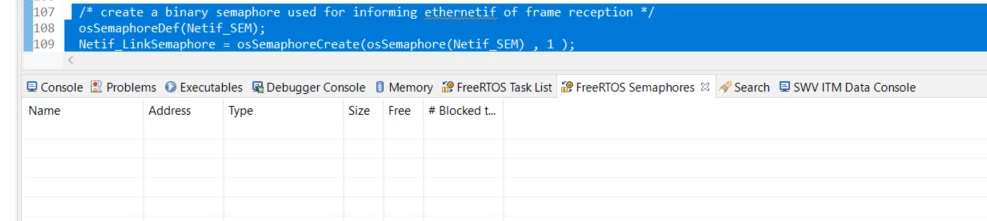

Empty list of window "FreeRTOS Semaphores" in STM32CubeIDE 1.5.0 (STM32F746Nucleo)
iTrying to watch semaphores status, inited by LWIP cubeMX. And see empty window. I know that semaphores created (for example) in lwip.c file
 /* create a binary semaphore used for informing ethernetif of frame reception */
 osSemaphoreDef(Netif_SEM);
 Netif_LinkSemaphore = osSemaphoreCreate(osSemaphore(Netif_SEM) , 1 );
But cannot see any of them in freertos window:
0693W000006F62gQAC.pngthe window with monitoring tasks is working.0693W000006F63oQAC.pngWhat should i do to enable semaphore monitoring function?

The queue names must be added to the registry, see "6.2.2 Add to registry" in STM32CubeIDE user guide (UM2609)

Thanks a lot!!! It helps. The question is closed
