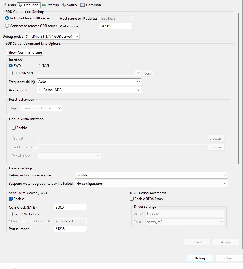

Does SWV work on the STM32H573 DK board?
Beside enabled it in the Debugger tab:
also called LL_DBGMCU_EnableTraceClock();
but when calling ITM_SendChar(), the ITM->TCR is still 0.
Do I miss anything else?  BTW, I am using the latest STM32CubeIDE 1.18. Thanks.
ThatseasyBest answer
Apr 2, 2025 12:21 AM UTC
After adding the following line:
SET_BIT(DBGMCU->CR, DBGMCU_CR_TRACE_IOEN);
The ITM_SendChar is working now.
