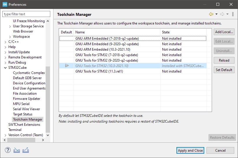

I suppose you would be interested by the toolchain-manager available in Preferences > STM32Cube:

Didn't know about that setting. Thank you.
