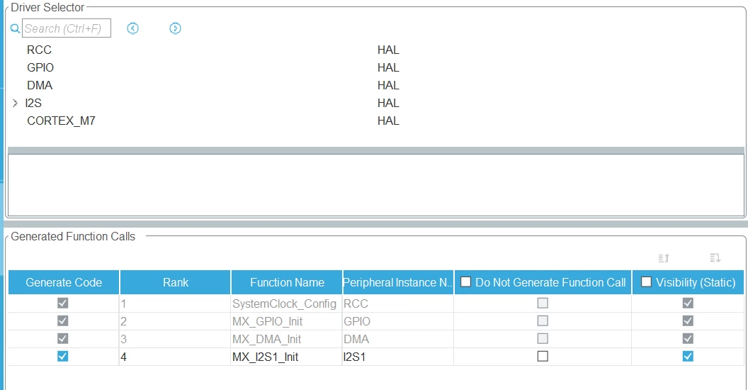

I'm debugging H723 with CUbeIDE1.14.0,but the generated code does not work.
no interrupt happened.

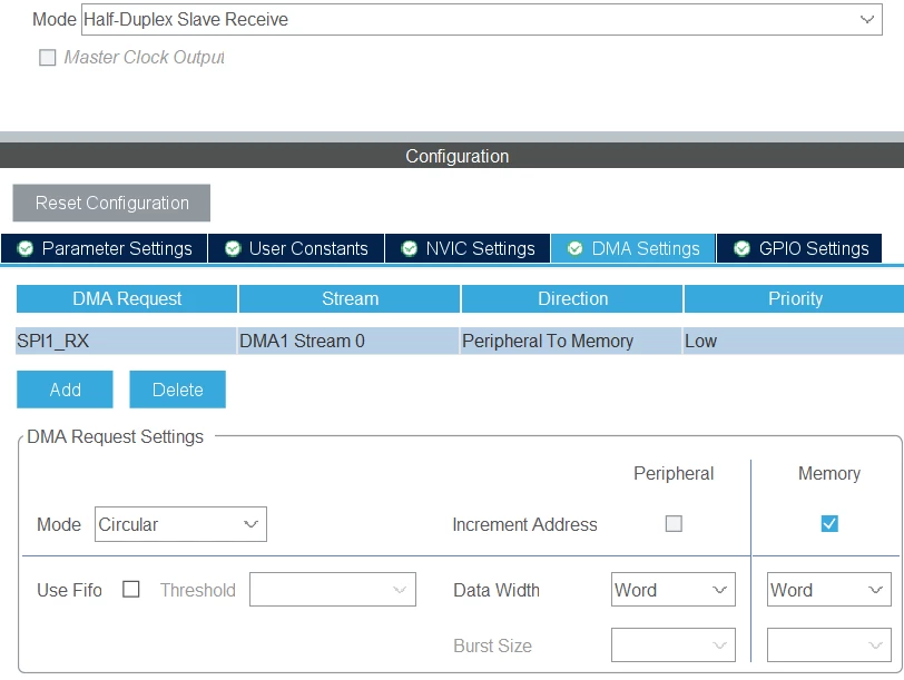

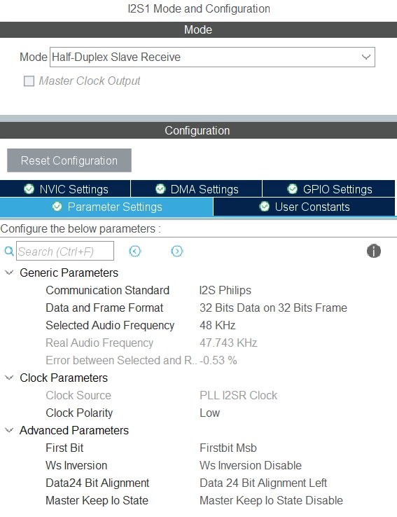

    1.disable DMA
    2.set I2S as half-duplex master transmit,it can send data out
    3.set I2S as half-duplex slave receive,it can not receive data.

    Hello @Binge,
    If you need to use interrupt process, you should configure the I2Sx interrupt priority and enable the NVIC I2S IRQ handle.
    If you need to use DMA process:
    Declare a DMA handle structure for the Tx/Rx Stream/Channel.
    ◦ Enable the DMAx interface clock.
    ◦ Configure the declared DMA handle structure with the required Tx/Rx parameters.
    ◦ Configure the DMA Tx/Rx Stream/Channel.
    ◦ Associate the initialized DMA handle to the I2S DMA Tx/Rx handle.
    ◦ Configure the priority and enable the NVIC for the transfer complete interrupt on the DMA Tx/Rx
    Stream/Channel
