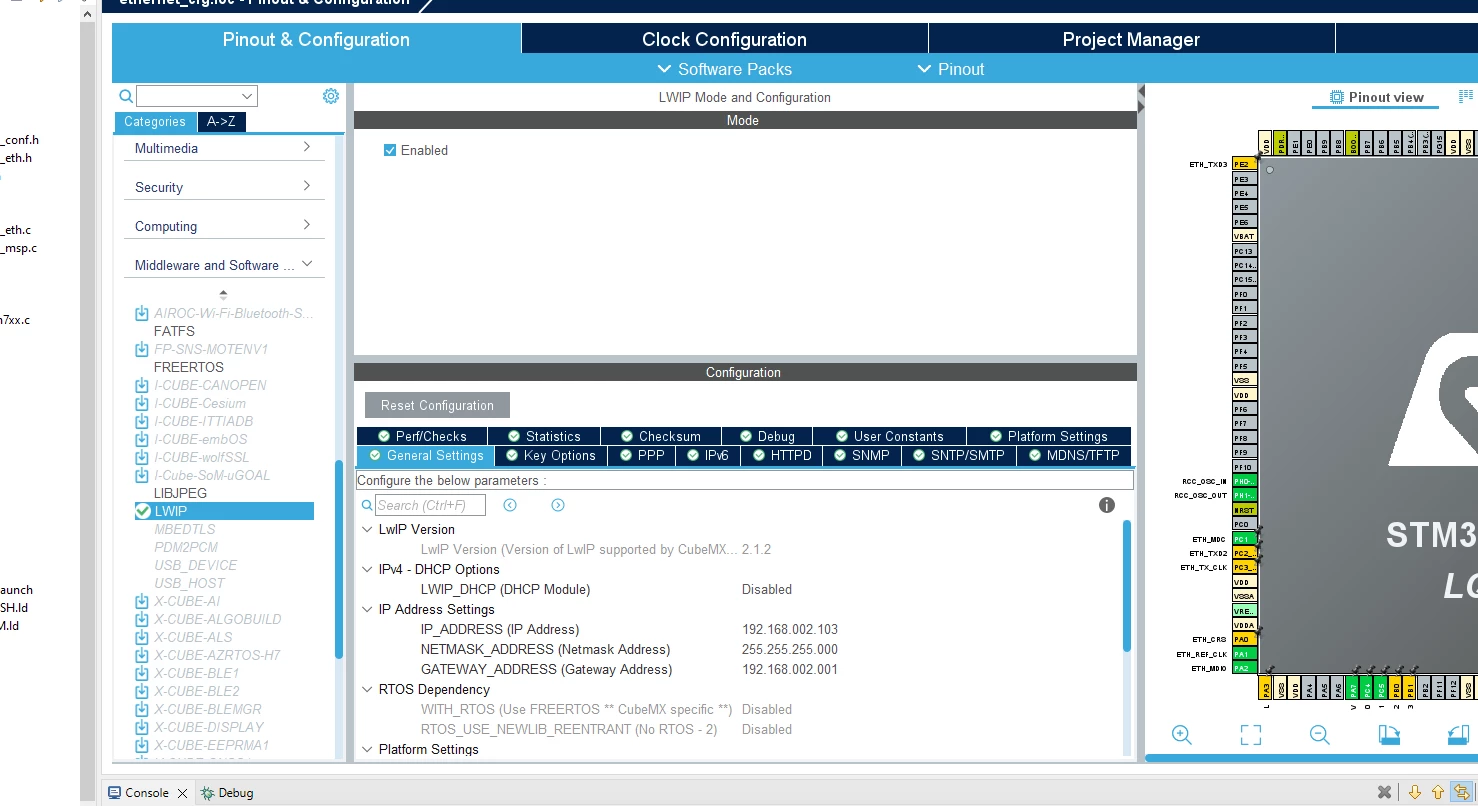

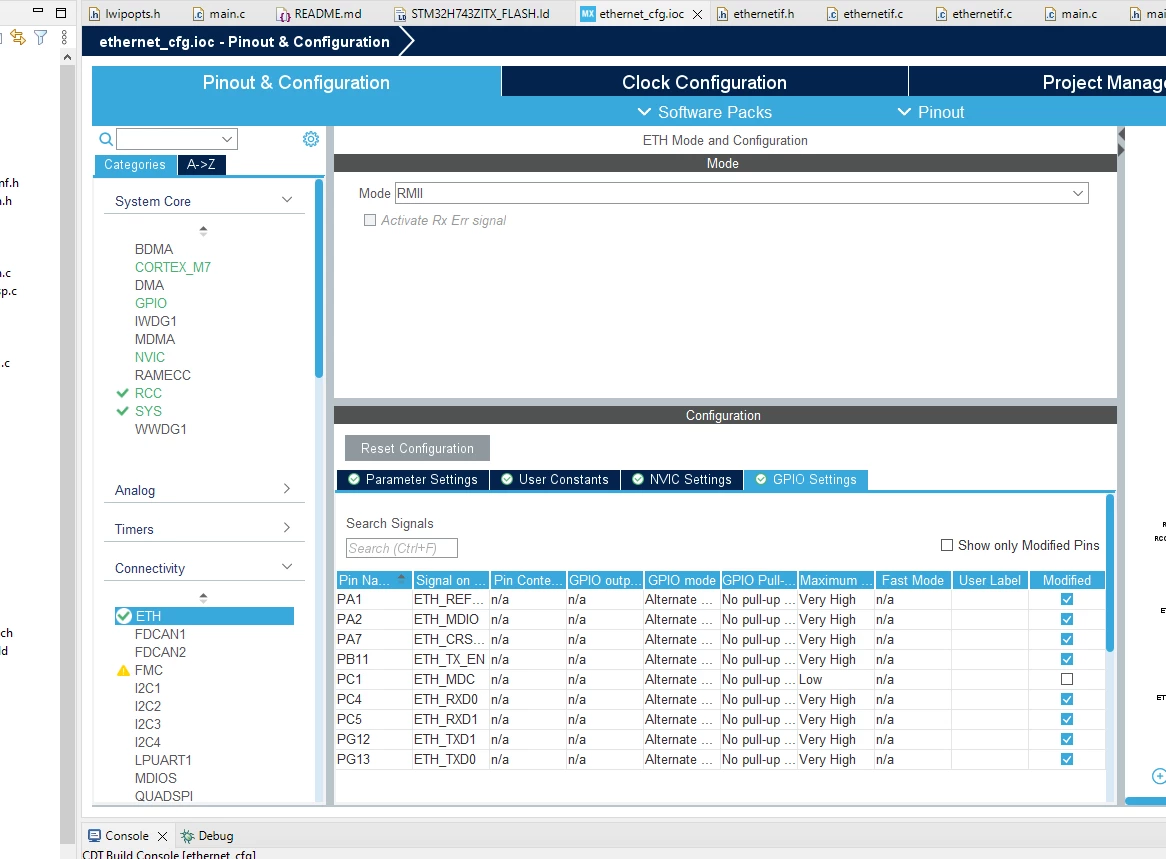

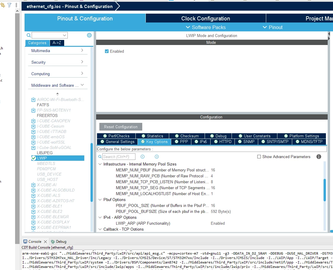

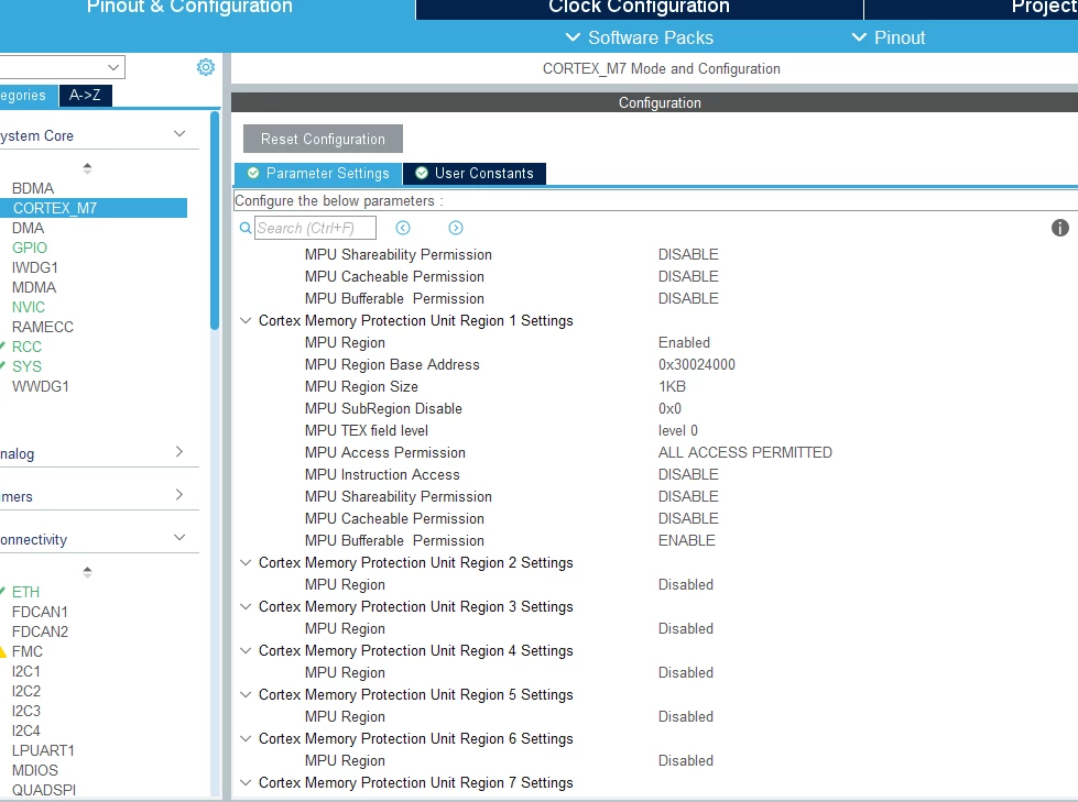

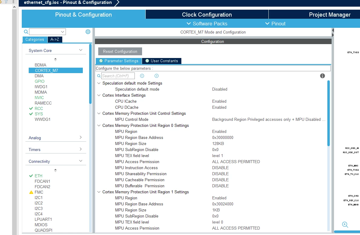

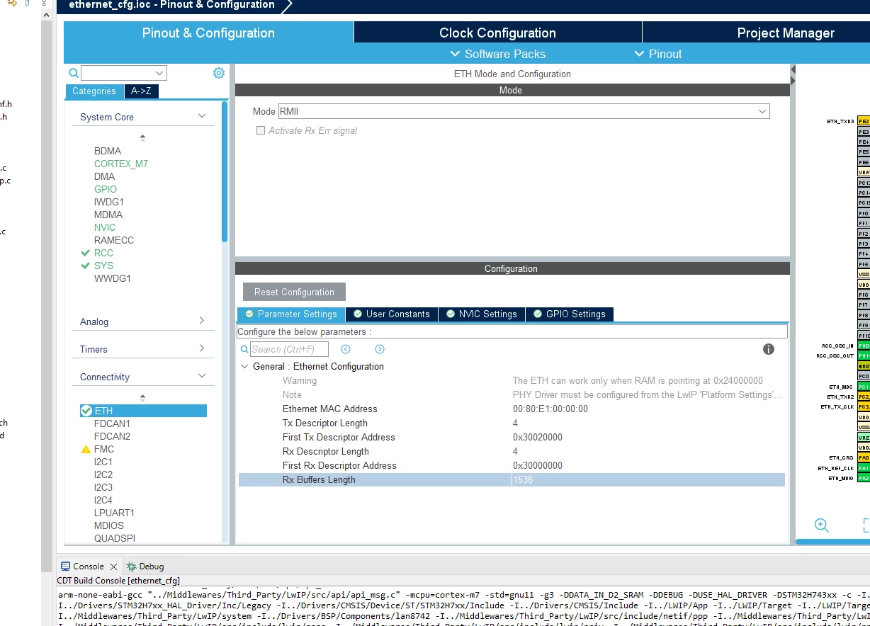

Please find thje above settings I did in cubeide. I called ethernetif_input() in main and trying to ping the IP addresss.The  ethernet connection is not established . I am getting error like host is unreachable. I tried all possible configuration of MCU, LWIP, ethernet settings from my side. Could You please guide me with correct settings
November 22, 2023
Ethernet is fairly difficult to program as there are a lot of components to it. Can you get an example project working?
Getting the CubeMX example LwIP_HTTP_Server_Netconn_RTOS to run should show basic functionality.
