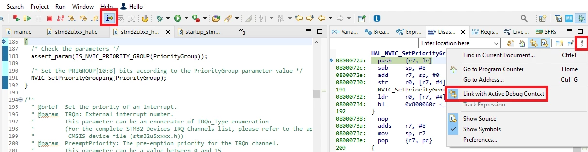

GDe M.1
Visitor II
this seems working on my side:
