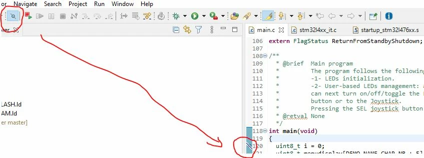

How can I disable breakpoints for release builds? If I accidentally forget a breakpoint on, and it gets hit in the release build, then the program just freezes (including halting the watchdog timer!) - what am I missing?

Nothing related to build here but debug / run. Having breakpoint set is not leading to any compile result variation.
If you're expecting to run your application getting rid of existing breakpoints just disable them Thanks "Run > Skip All BreakPoints" or dedicqted toolbar shortcut icon:

I did see the "Skip All Breakpoints", which I've now taken to enabling before building (still not an ideal solution however).
"Nothing related to build here"
I would have thought so, but that does not seem to be what I am seeing! I am guessing that the hardware breakpoints are being hit, even though I don't have the debugger running (it is still plugged in however).
When debugger is not active, the breakpoint instruction causes "debug monitor" exception.
If it is not specially enabled it escalates to hardfault. So you're getting a hardfault.
The simplest is not to use breakpoint instructions in release configuration.
Or, in release mode you can enable the "debug monitor" handler and dismiss these exceptions (complicated).
-- pa
