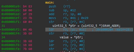

I have following code snippet, when I compile it with -O0 optimization level it gives below assembly code and I can observe value address on Expression window. But when I compile it with -O3 optimization level I couldn't observe address of value.
Where is the storing location of value when compiled it with -O3 ?
#define SRAM_ADDR 0x20000004U
int main(void) {
	uint32_t value = 41;
	uint32_t *ptr = (uint32_t *)SRAM_ADDR;
	while(1) {
		value = *ptr;
		if(value) break;
	while(1);
	return 0;
Disassembly :
-O0 optimization :
-O3 optimization :
    Best answer by waclawek.jan
    Make value volatile, otherwise optimizer optimizes it away entirely.

    value is simply held in register r3, and stored within the local stack frame [r7+4] or [sp+4]
