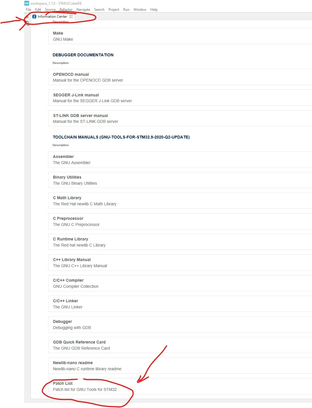

Cartu38 OpenDev
Graduate II
July 20, 2021
Good way to get it is from tool itself
pointing to <CubeIDE install path>/plugins/com.st.stm32cube.ide.mcu.externaltools.gnu-tools-for-stm32.9-2020-q2-update.<qualifier>/docs/gnu-tools-for-stm32_patches.pdf
