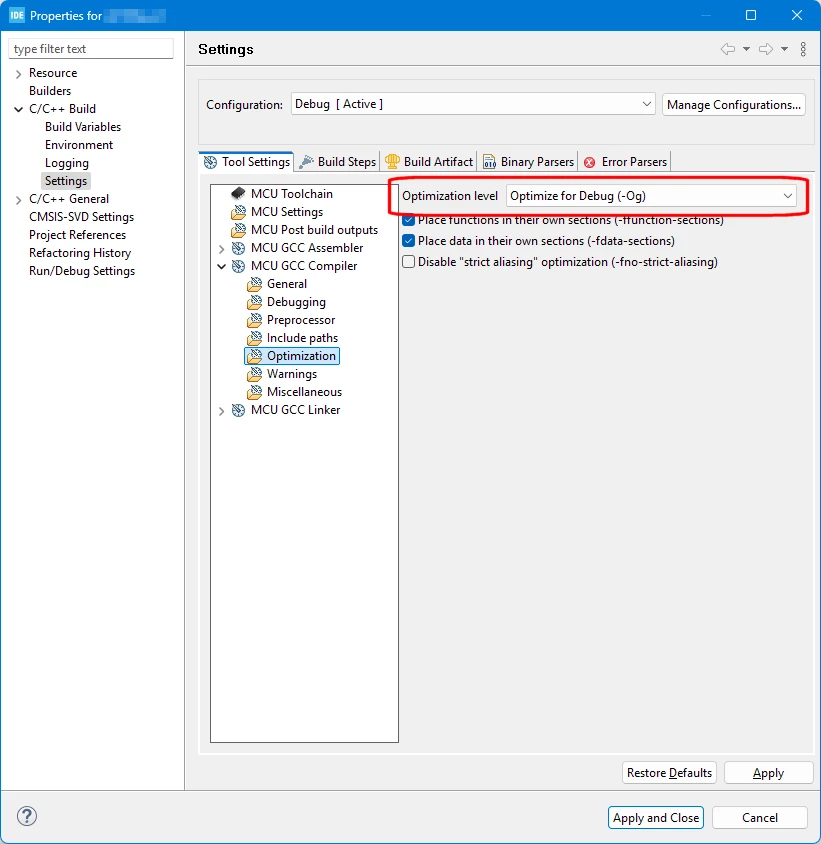

Andrew Neil
May 12, 2025
@TDK wrote:
If your program is too large to fit into flash, compilation will not complete and the ELF will not be generated.
^^ This! ^^
@TDK wrote:
You will need to reduce the code size in order to compile the program. One way to do this is to switch to the Release configuration, although this makes the code harder to debug as things are optimized away.
@Tunahan  Or set your Debug configuration to use -Og - see my earlier reply.

Andrew Neil
May 12, 2025
@AScha.3 wrote:
To reduce the program size, try: set optimizer -O2 , then compile.
@Tunahan  Before that, I'd try 'Optimise for Debug (-Og)'
This should give you the best compromise between optimisation & "debuggability"
