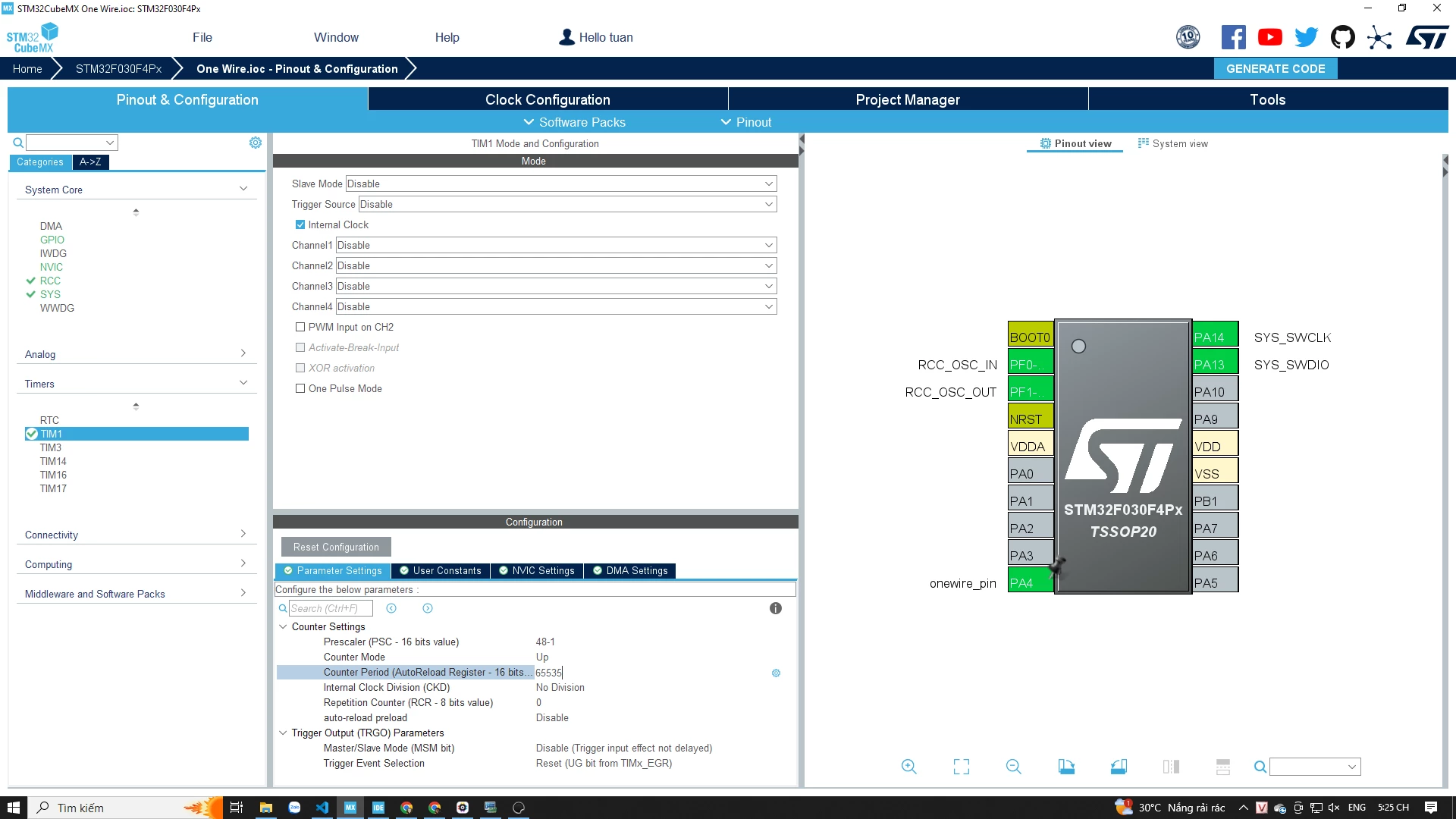

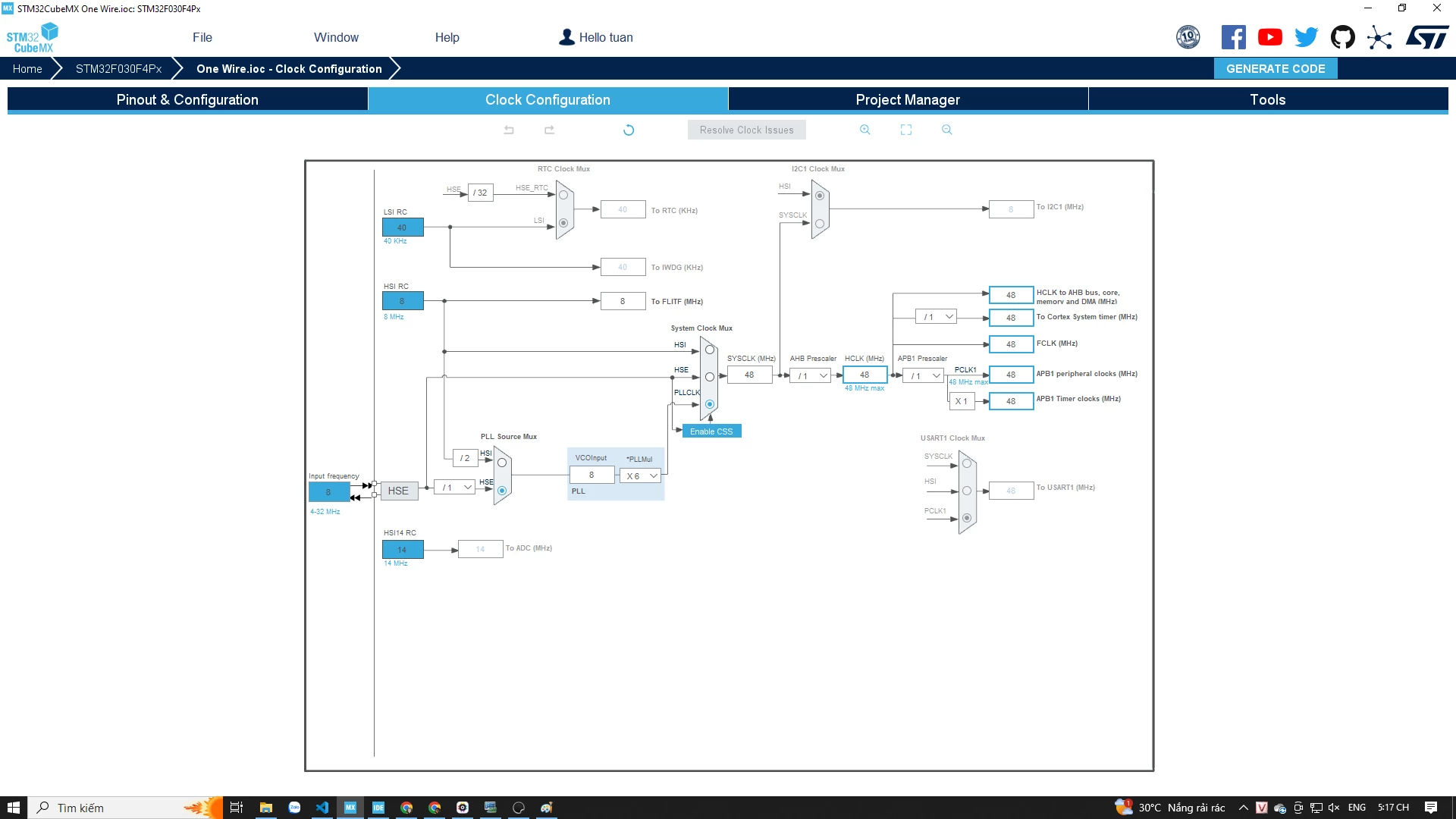

Hi, I want to create delay us using stm32 F030F4 max CLK =48M, I based topic "Microsecond/Nanoseconds delay in STM32" of ControllerTech. but when I mesuare by logic alnalyzer, It is wrong! A nyone tell me why? Thanks!
    6 replies
    August 2, 2023
    void DELAY_TIM_Us(TIM_HandleTypeDef *htim, uint16_t time)
    	__HAL_TIM_SET_COUNTER(htim,0);
    	while(__HAL_TIM_GET_COUNTER(htim)<time){}
    Not the greatest scheme, but it should work ± overhead. Why do you think it's wrong?
    stark2Author
    August 2, 2023

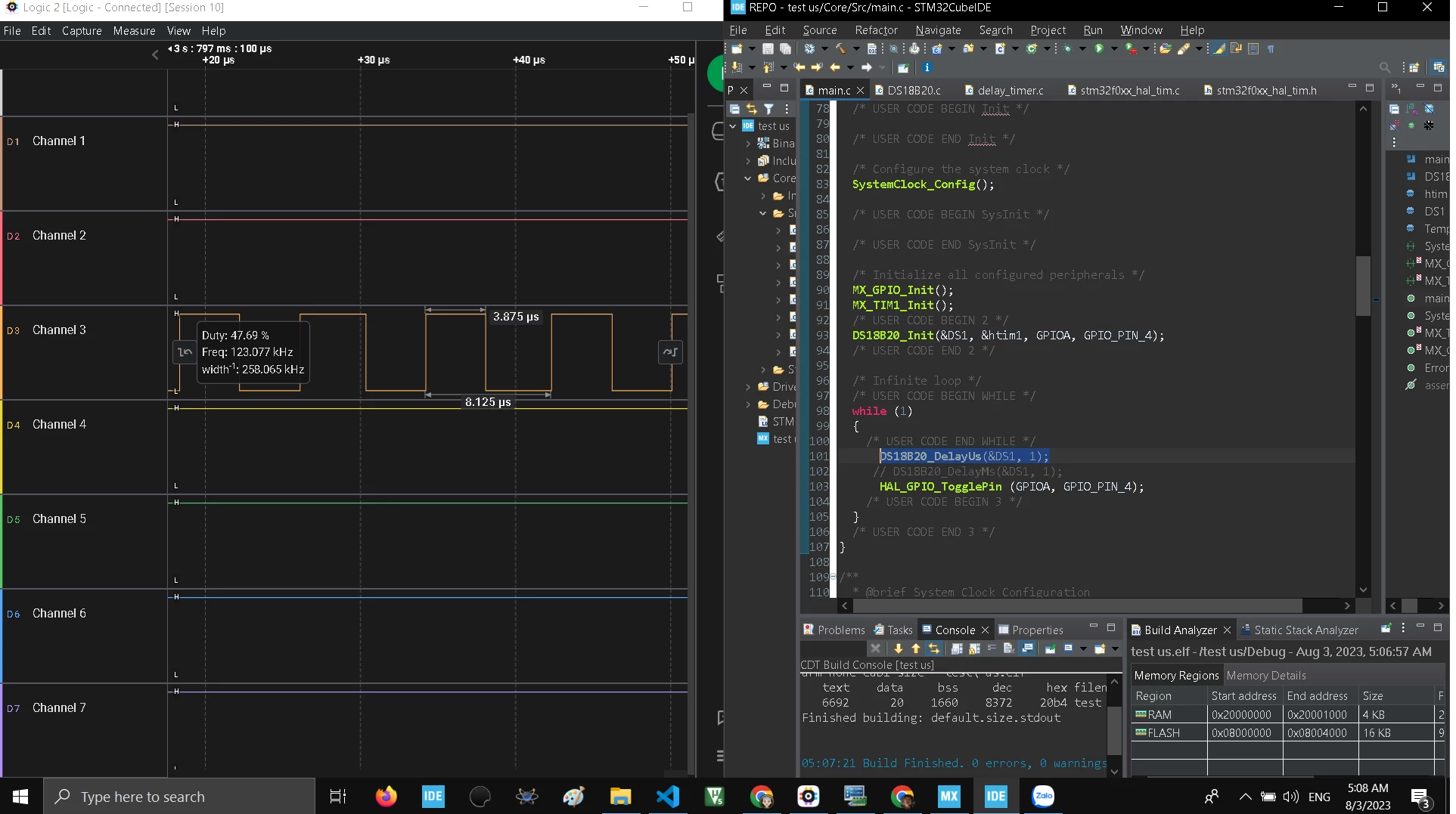

    delayus.pngwhen I use function "DS18B20_DelayUs(&DS1, 1);    // delay 1 us ". result in logic analyzer = 3.875us.
    Do you know why is that?
    August 2, 2023
    That is due to overhead and jitter in your timer. Calling functions takes times, returning from functions takes time, your timer has increment of 1us, so expect a jitter of 1us on top of the overhead.
    You can get more accurate by using DWT->CYCCNT, reducing the function calls to a minimum, and compiling your code with optimizations on, but you will always incur some amount of overhead.
    Do a 1s delay (or 1ms) and see if the actual delay is close to expected. Overhead will be minimal in that example so it will tell you if the timer is running at the expected rate.

    How wrong? Perhaps express in units of time or frequency..
    Perhaps your expectations or premise is wrong? Is the MCU actually running at the frequency in question. Could you print out the frequency and bus clocks to see what the MCU thinks its running at. Check HSE_VALUE matches what's clocking the MCU.
