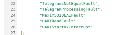

Hello community,
I use CubeIde to program my STM32 L051R6T6.
Language is C.
I do the following definition in a .c file:
enum internalFaults{
	internalFaultsTransmitPrepare,
	internalFaultsTransmit,
	internalFaultsWatchdogAlarm,
	internalFaultsTelegramsRxSequence,
	internalFaultsNoTelegramsReceived,
	internalFaultsTelegramsNotEqual,
	internalFaultsTelegramProcessing,
	internalFaultsMaxim5320EAI,
	internalFaultsUARTRead,
	internalFaultsUARTStartRxInterrupt,
	internalFaultsCount,
const char* internalFaultNames[internalFaultsCount]	=
	"TransmitPrepareFault",
	"TransmitFault",
	"WatchdogExeededFault",
	"TelegramsRxSequenceFault",
	"NoTelegramsReceivedFault",
	"TelegramsNotEqualFault",
	"TelegramProcessingFault",
	"Maxim5320EAIFault"
	"UARTReadFault"
	"UARTStartRxInterrupt"
There is no write access to internalFaultNames or to its char[]'s.
But when I read from it
strcat(message,internalFaultNames[faultIndex]);
It only works, if faultIndex is 0 <=faultIndex<8.
internalFaultNames[internalFaultsUARTRead] and internalFaultNames[internalFaultsUARTStartRxInterrupt]
are NULL.
This I can see in the debugger too.
Is this a special restriction of STM32 MCU or the Compiler user in CubeIDE?
Thank you.

missing line end comma , lines 24 + 25 ; so index end is 8.

OMG, what a stupid mistake. I was also wondering, why the 8th string was not terminated and continues with the text of 9th and 10th.
Sometimes, I'm a little bit blind.
Thank you, and sorry for that question.
