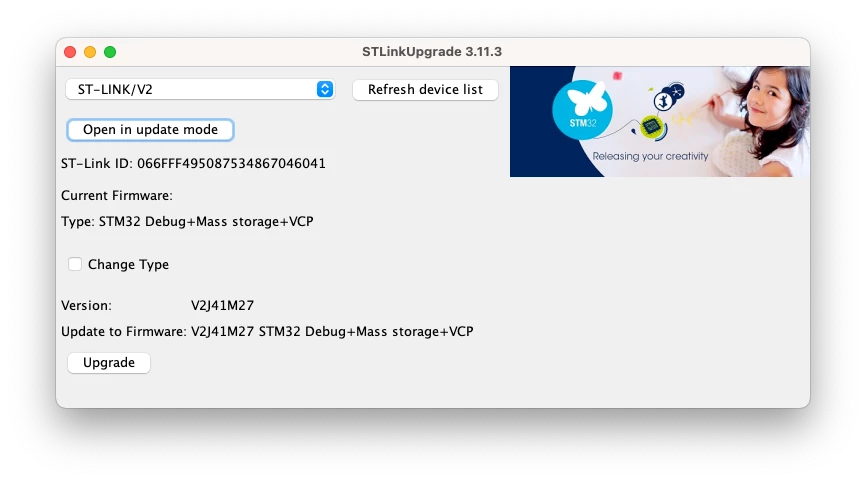

Just installed the tools and connected an STM32 Nucleo 144 for the first time.
After connecting it, a ST-Link upgrade window popped up about updating the firmware of the board which I did. Got the Upgrade successful message, but if I open this window again and choose the Open in update mode, the following option still shows up and lets me upgrade again.
After creating a test project, when I try to start Debugging, it fails due to no connection to port 61234. I'm using the Autostart Local GDB Server option.
I tried changing the port number and also the ST-Link Open OCD but still can't get the debugger to work
