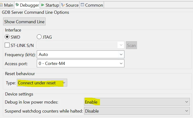

unless, you are working on a low power application I wonder you to enable low power debug mode and connect under reset as shown in the screenshot below:
0693W00000Y92lSQAR.pngAlso, you have to mass erase the flash memory using the following link that may help you to do that:
How to solve debugger connection issues (st.com)

I am trying to run a program that worked on a Nucleo-L476RG on a L452RE microcontroller
I tried what you told me to do, but alas, I failed.
