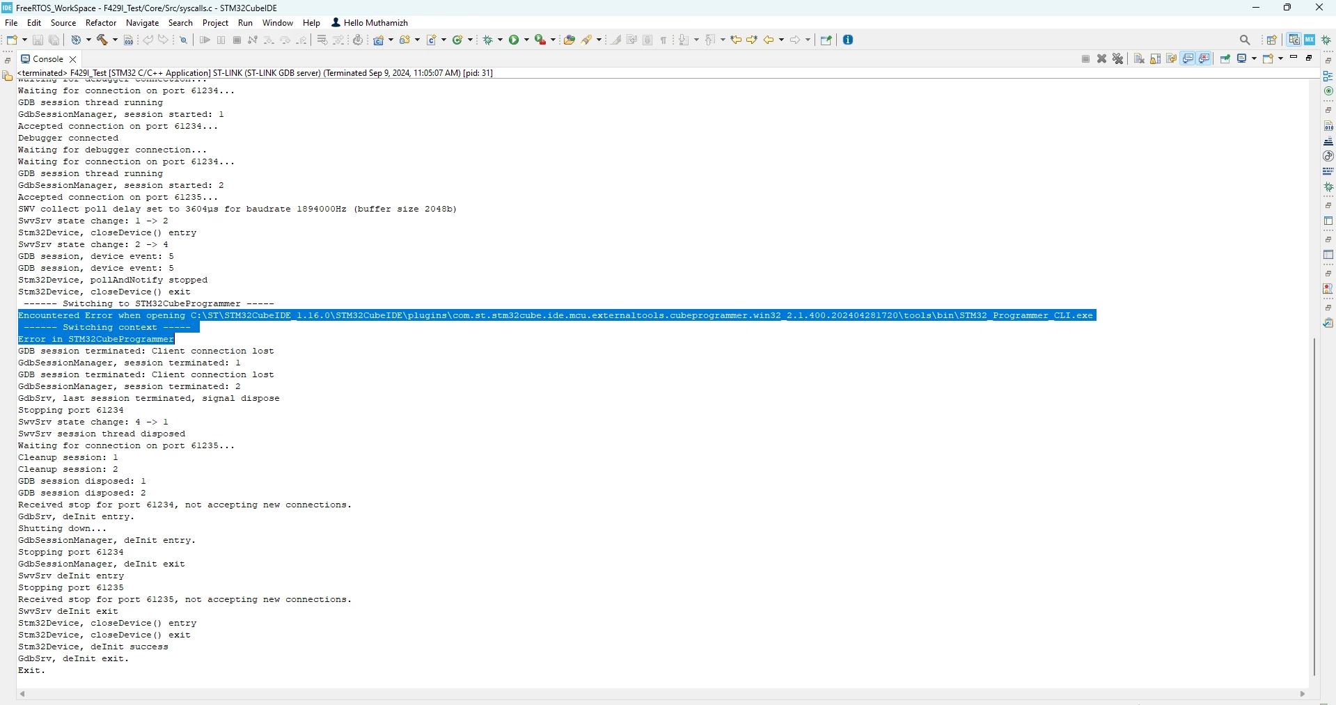

I HAVE USED THE ST LOADER  YOU HAVE SUGGESTED FOR MY LAST PROBLEM AND NOW ALSO IT REPEATES TEH SAME PROBLEM THERE IS PROBLEM WHILE OPENING THE STM32_PROGRAMMER_CLI.EXE. SUGGEST ME A SOLUTION FOR THIS OR AN ALTERNATIVE.

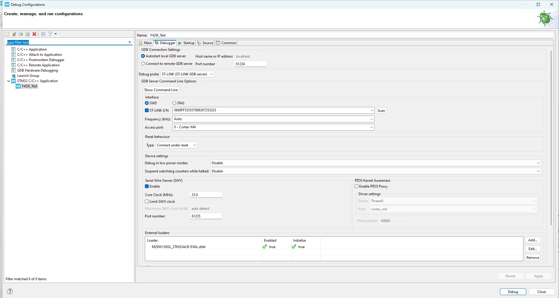

THIS IS THE DEBUGGER CONFIGURATION AND THE STLOADER I HAVE SELECTED.

@Muthamizh wrote:
 i don't find any stldr file for my stm32f429i series.
How? any loader? already provided you one.
Also in the CubeProgrammer, this is the list of all loader available for this board. And the one in the red rectangle corresponds to the NOR Flash loader.
I used this Loader with STM32F429-EVAL board and it works well.
I don't think the error you are showing has a relation with the loader.
Could you please share your project (in PV if you don't want to share it in public) so I can do a test?

Why did you duplicate this thread instead of replying in it? https://community.st.com/t5/stm32cubeide-mcus/external-loader-file-not-found/td-p/717263
Please don't duplicate the same topic.

Okay but i need better visibility to my problem i don't find any stldr file for my stm32f429i series.
could u please look into it to solve the issues.  :)
Note: I had also tried the solution u had suggested for this previously.
MuthamizhAuthor
September 11, 2024
My board series is STM32F429I-DISC1 does the STM32F429-EVAL &STM32F429I-DISC1 are different or both functionality and all other specs are same.
mƎALLEm
September 11, 2024
There is no EXTERNAL Loader for STM32F429I-DISC1.
Whey in the previous post you are looking for an external loader? I thought you are using an EVAL board.
MuthamizhAuthor
September 11, 2024
Okay how can I use IDE to work with this board do you have any idea.
