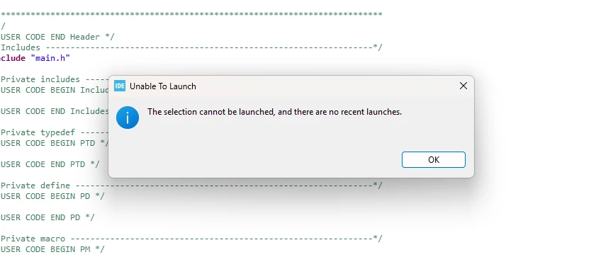

I am unable to debug my code currently, due to the debugging configurations not being set up - this is from importing the cubemx project into the cubeIDE. an error saying the selection cannot be launched but when attempting to add configs in the debugging properties it does allow me to add any - is there anyway of using default debugging and running settings without having to add custom ones?

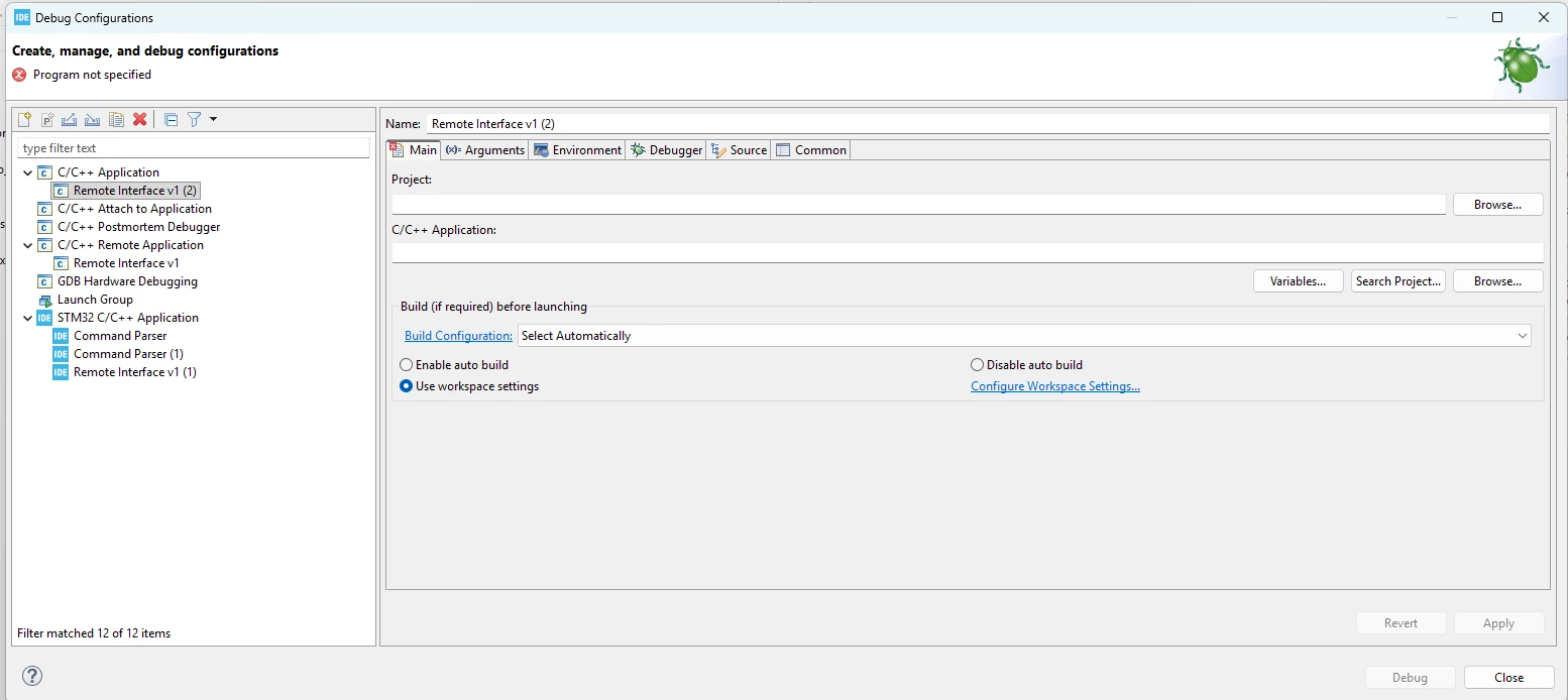

In order to set up your debug configuration correctly, you must follow these steps:
  • Build with Project > Build Project
  • Go to Run > Debug Configurations...
  • Create STM32 C/C++ Application
  • In Main:
          select Project
          select .elf file
BR, Souhaib

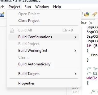

for me the build project is greyed out

Hello ​@mslwd8797
It seems that the project has not been imported properly.
In order to import AN STM32CubeMX project into STM32CubeIDE, go to: [File]>[-STM32 Project Create/Import], select [Import STM32 Project] > [STM32CubeMX/STM32CubeIDE] and click on [Next >].
Then select the correct project from the popup window
BR, Souhaib
